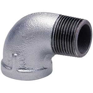

If you are having a space problem you should ask for a short radius iron street elbow.
This is male on one side and the thread runs right up to the bell of the female side.
It will look something like this:

Thanks Ardwrkn,
I found street elbows, but I didn't know that their might be some special short radius ones. I'll check that out.
hj
