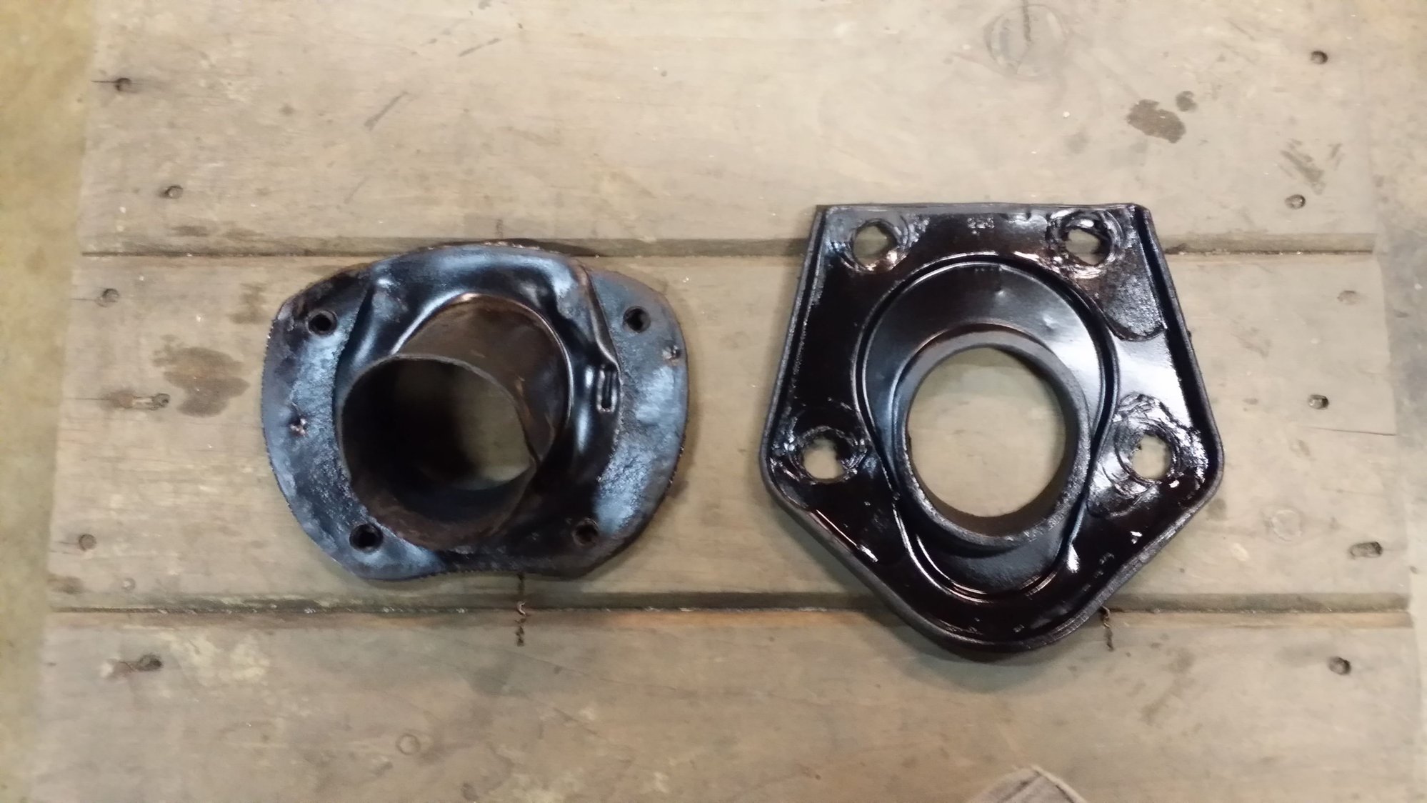

If you put a shorter column in that will couple to a Saginaw power steering box, you'll need the shorter column bracket that goes on the engine side of the firewall.
My (taller) '69 F100 manual steering column bracket on the left, (shorter) power steering column bracket on the right.
If changing from a manual steering column to a power steering column (with Saginaw box), you'll also need to change out the firewall column seal.
My manual steering column seal on the left, power steering/tilt column seal on the right.

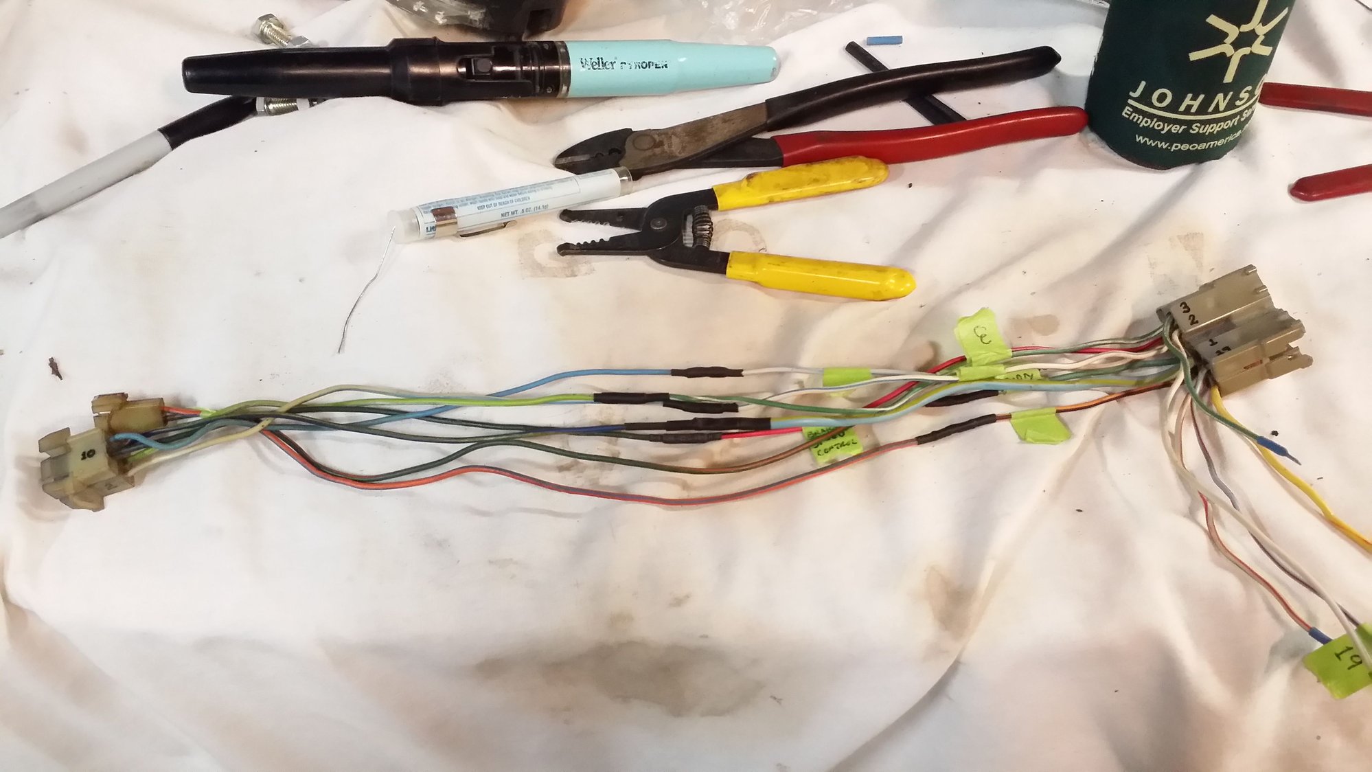

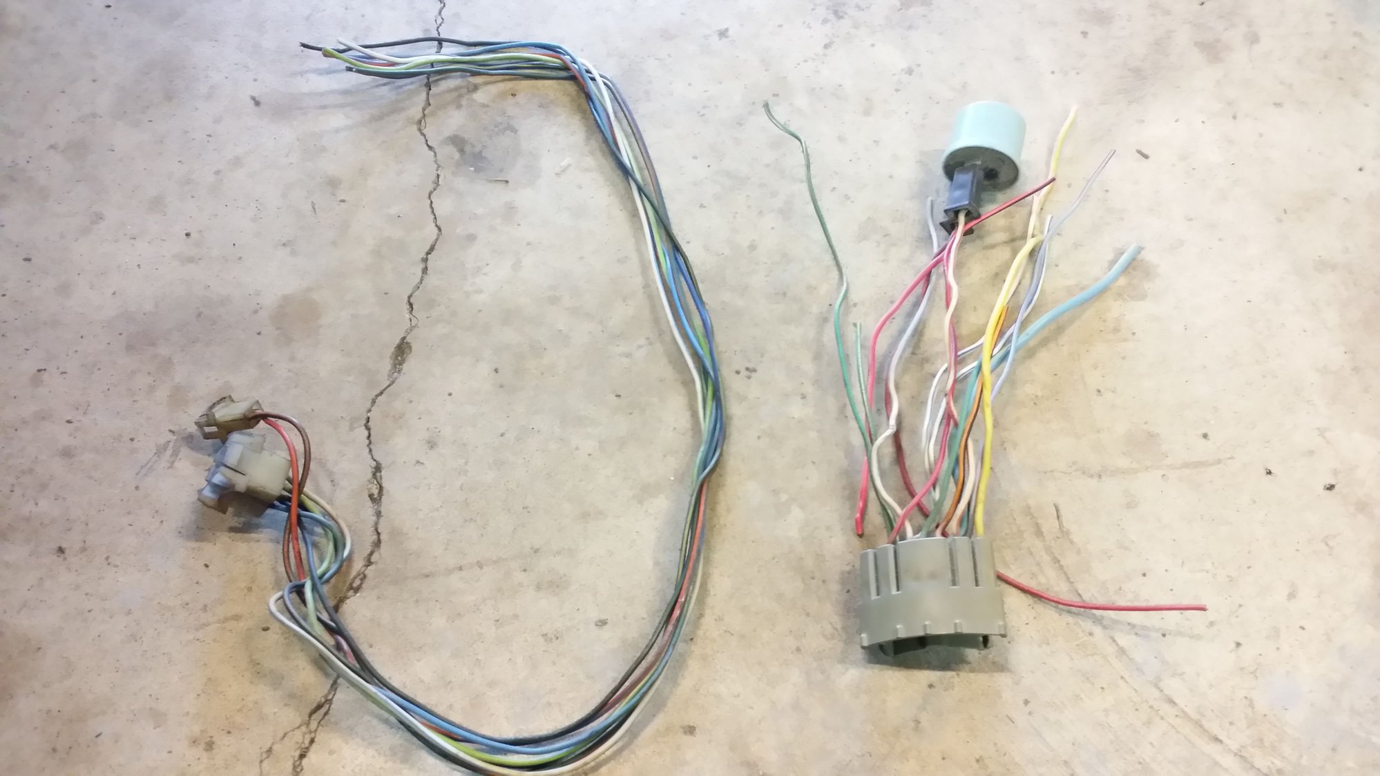

The Bumpside main wiring harness connections to the Dentside column connector is different. The Bumpside has two connectors and the Dentside has a larger, single column wiring connector. I didn't want to cut my original Bumpside wiring harness to splice in the Dentside tilt so, I cut the connectors/wiring off my old Bumpside turn signal switch and spliced them into a Dentside connector. I made a short 'patch cable' that would plug in, in between the original two main wiring harness connectors and the single connector to the column wiring.
Connectors/wiring I cut from my old Bumpside turn signal switch on the left. Dentside connector on the right.
Connectors spliced and soldered together to make the patch cable.

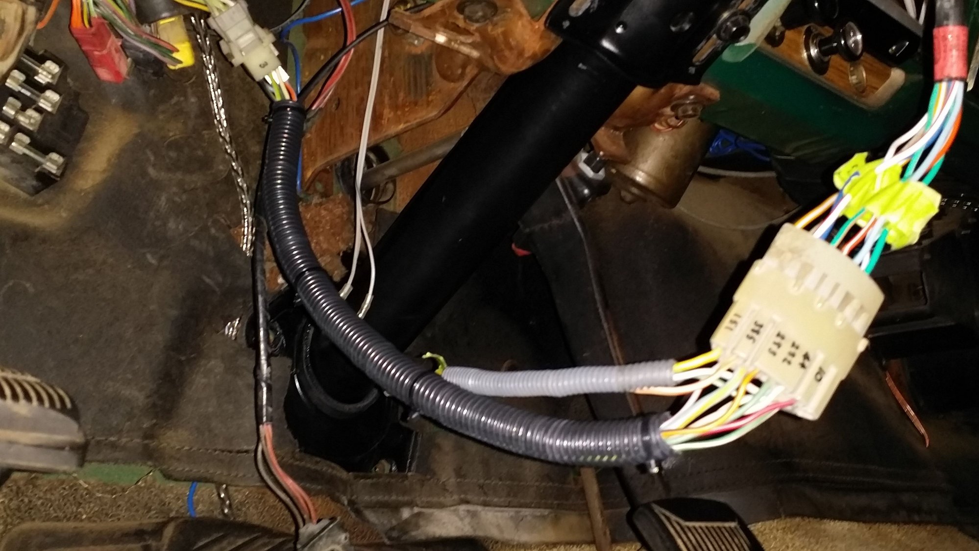

The patch cable installed between the Bumpside main wiring harness connectors and the connector on the Dentside column.
After the cable was connected up, I tucked and secured the wiring up under the dash. (I have the plastic column trim piece from the Dentside the tilt column came from. It would not fit between the column and my dash).
