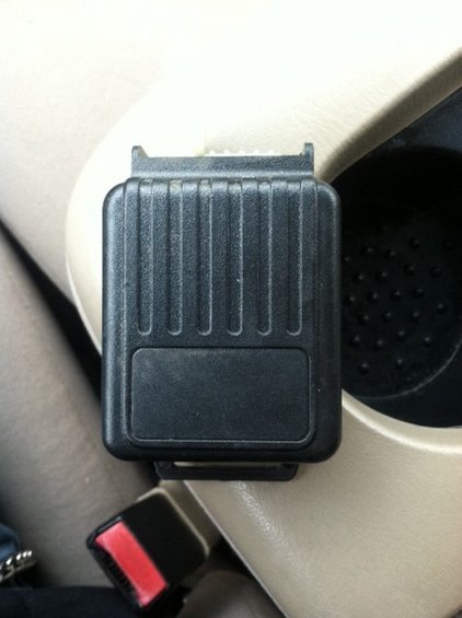

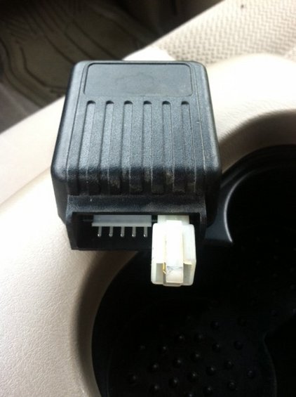

FINALLY! Figured out what it was. The previous owner installed something aftermarket...not sure what it is. Here's a couple pictures of it:
I was feeling all the relays I could find when I heard the click. Then I heard it coming from around the brake pedal area. Felt around, and there it was. Felt the click coming from it. I unplugged it, and my lights stay off now. Now I just have to figure out what this is. There's no part numbers on it, and it was just spliced into the regular wiring harness.

Way to go!
Wish I could help ID that little Black Box.
No chance of just asking PO?
