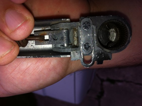

Here's a close up of the tab:
some how the pictures are upside down but you should be able to get it

Ok thank you so much I got the passenger side to come off but the driver side doesn't have one of those clips and doesn't want to come off

Most likly the PO broke the tab with a screw driver and then JB the arm back on the post...
Dont ask me how I know.

alright never mind I got it off I put a flat head screwdriver in place of the clip and it came right off thanks for the help everyone!
