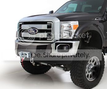

I was a bit leery of the 12k myself. I was leaning heavily to the 16k but the zeon just looked too cool. So I have a couple of ****** blocks and I think she should be fine. If I get so stuck 24k can't get me out I probably should leave the truck there anyway.
Sorry, not much help, but here are a couple of pics
