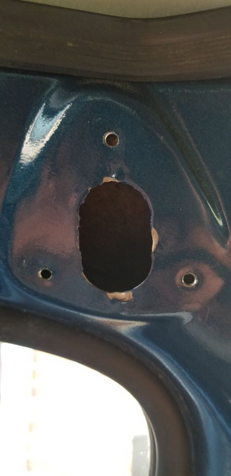

Originally Posted by ALBUQ F-1
Take a punch and give it a good smack near the edge of the pre-punched hole. I was leery of doing damage but it opened right up. Gentle tapping did nothing. YMMV... With fresh paint, you may want to score the paint around the edge.
ALBUQ F-1,
Thanks for the guidance. I installed visors in my 55' cab this evening. Passenger side needed to be drilled and "knocked out"
Factory finished before "knock out"
After "knock out"
Passenger Side
DRIVER side
