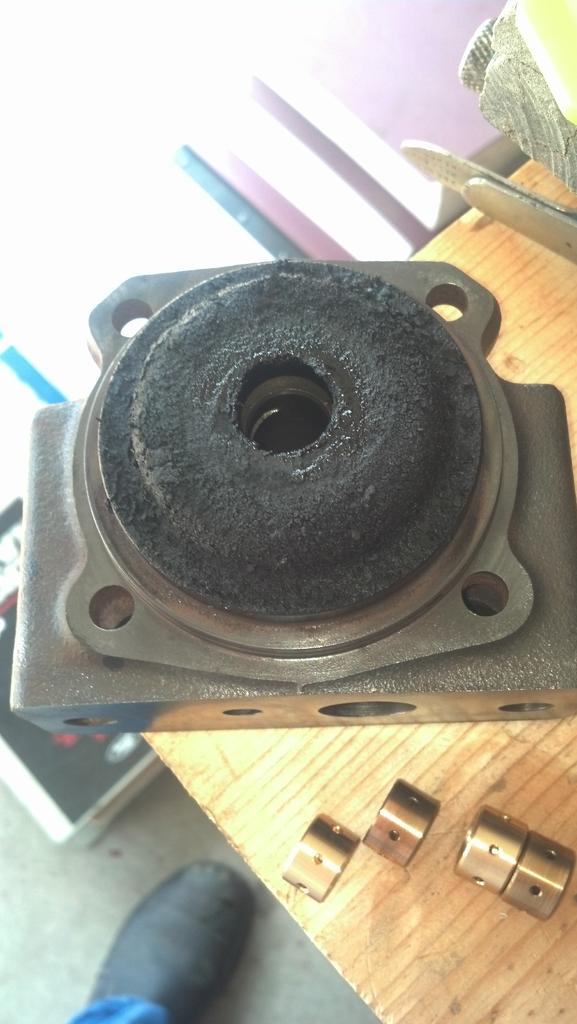

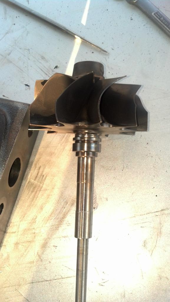

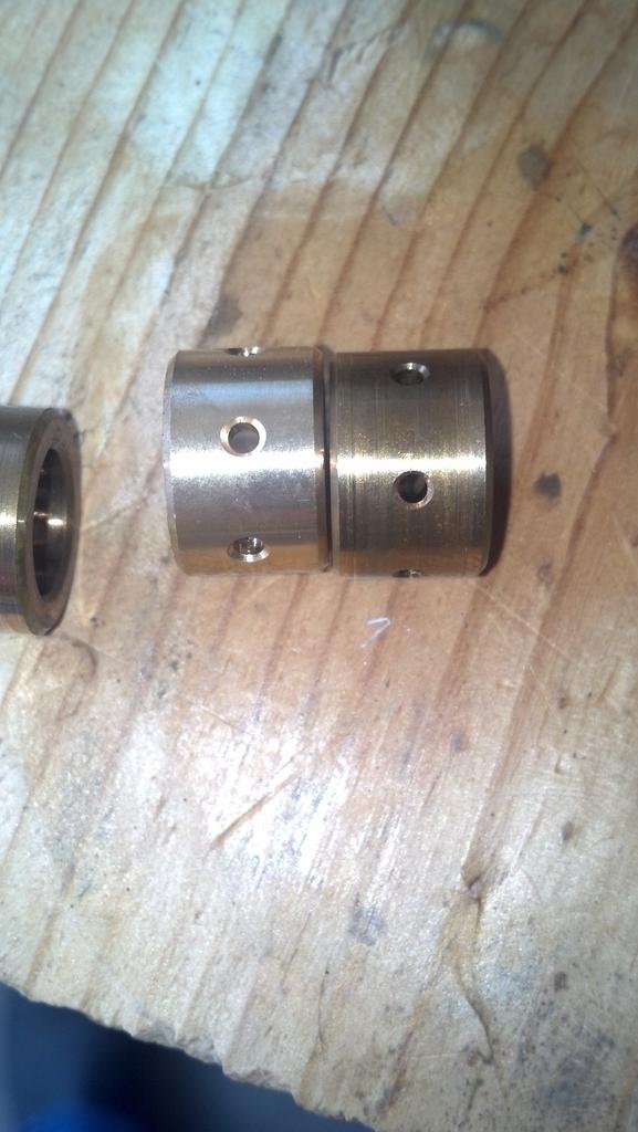

This is why I wanted to rebuild my turbo after 220k miles:
The journal bearings starting to show some pretty good wear on their surfaces.

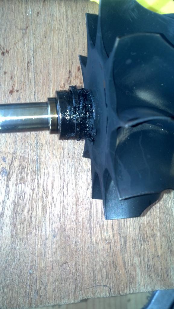

And the oil was extremely coked up around the turbine side oil seal ring. The little oil ring seal was probably starting to fail.

Yah the buildup all around that ring and shaft are a familiar nastiness.
A nitro solvent in a spray form has done good for me getting that crap off... i usually use that winchester powder blast...
Lookin good Brother Mike!

Here are the same parts all cleaned up...my die grinder and wire wheel are my best friends right now.
I have some photos of the re-assembled and painted turbo I will post up.
Keep in mind guys, my turbo had no play in the shaft/wheel, but I could feel the grooves in the bearings with my fingernail. Like Rich is saying about injector cups...maybe there is a mile mark you should just rebuild it to keep it from failing on you.
