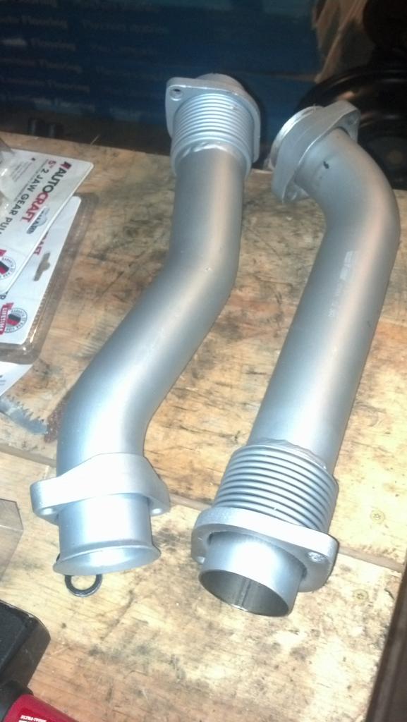

Ok...the up-pipes are painted and cured in the oven. Silicone exhaust paint.

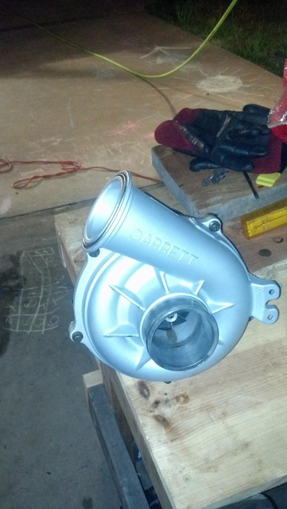

The turbo is rebuilt and back together with paint. 2000* black rustoleum high heat and 1500* aluminum silicone exhaust paint

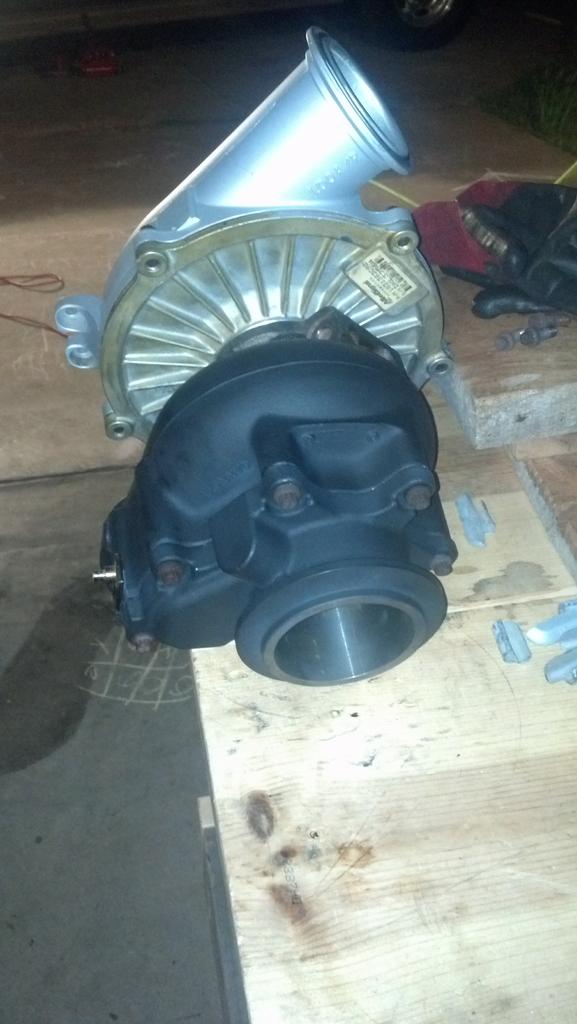

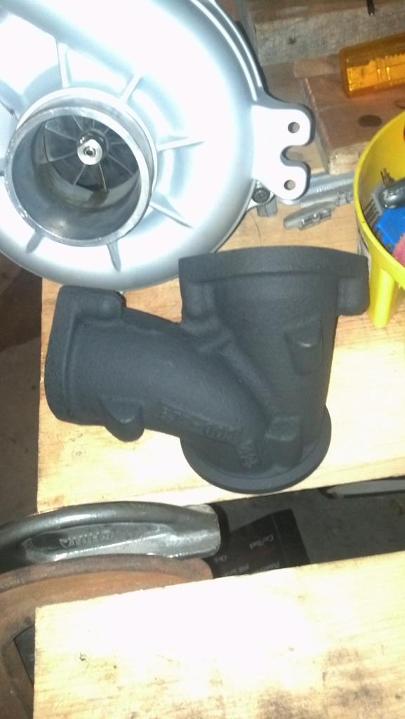

Babies butt got paint, too. 2000* black

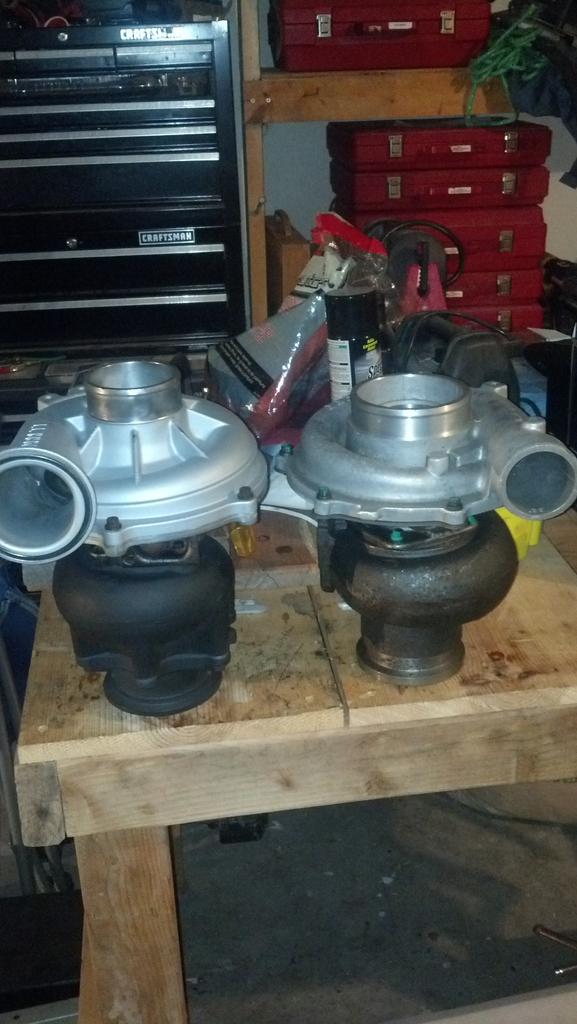

And here is an eye candy photo...
Whoever guesses what my "little" GTP38 is sitting next to gets first prize. Christof and Woody are excluded from the guessing game since they already know what it is.

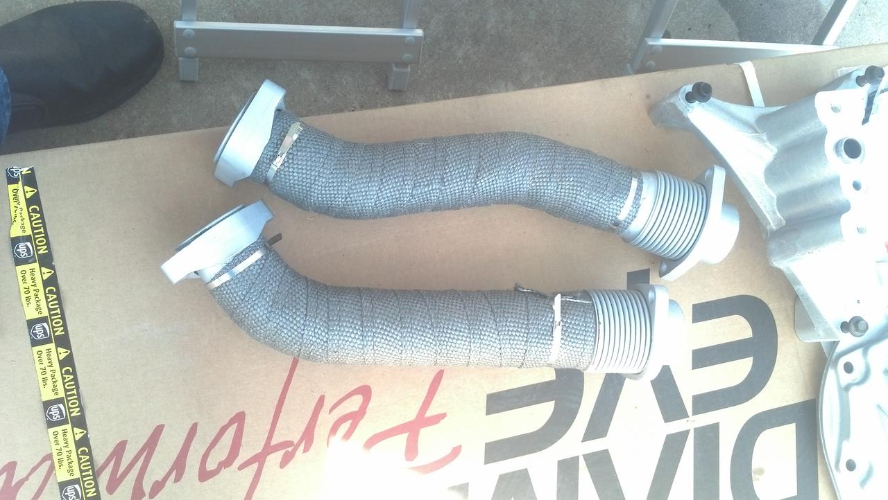

Bellowed and WRAPPED up-pipes. Can you say super efficient?
One more coat of paint over the top of that wrap and they go on. One 15' roll of wrap easily does both pipes.
