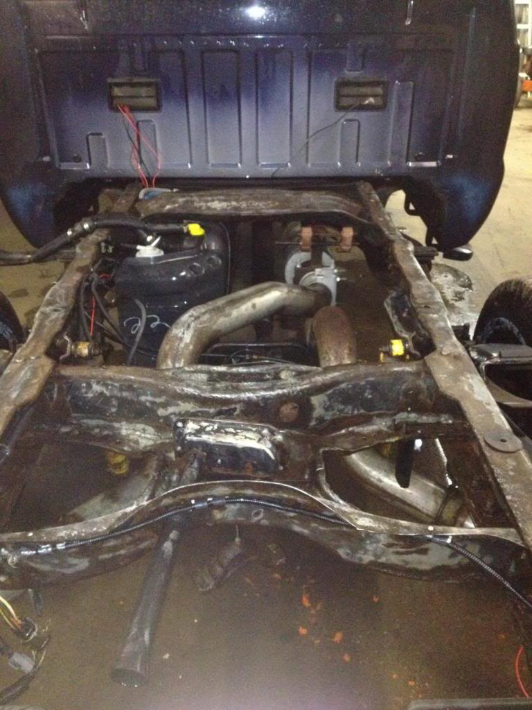

Well I got the project started last Wednesday so here is the progress.
This is what it looked like when I just took it off

Old Jun 8, 2013 | 08:47 PM
brwolfjr's Avatar
brwolfjr
Joined: Dec 2003
Posts: 658
From: Wayne, PA
Are you going to coat the frame rails?
It also look like you need some exhaust work.

This is after lots of wire brushing

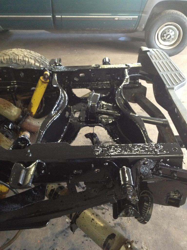

This is after 2 coats of POR15
Tomorrow I plan on sanding and painting the bed..... More Pictures to come.
I think the above pictures should answer all your questions.
