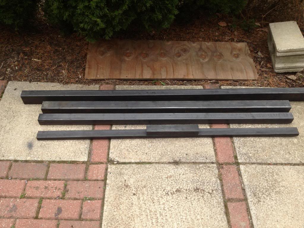

Originally Posted by fordtruck661
I used
Front support - 3" tall x 2" wide x 6' long
2nd support - 2 1/2" tall x 2 1/2" wide x 5' long
3rd support - 2" tall x 2" wide x 5' long
4th support - 1" tall x 2" wide by 5' long
And 1 1/2" tall x 2" wide x 1' Long (for the two spacers that sit on the frame)
I agree on not buying that kit off ebay all the steel coat me only $100 bran new and cut to size. (all the lengths given are a few inches longer than needed and will have to be cut to the right size.)

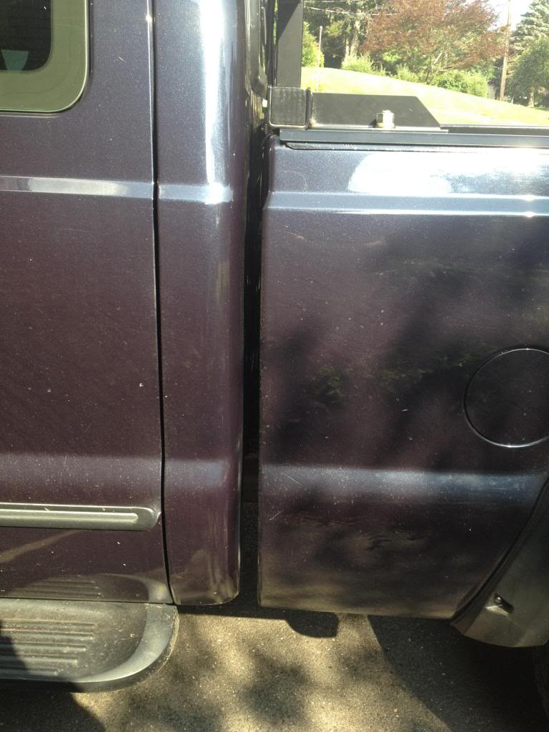

It lined up ok its a little off but not by much. You could put some washers under it to line it up better if you really want to.
Attachment 200427
Did you ever correct the vertical misalignment of the bed to cab body lines? If so, do you recall exactly what/how many washers or spacers you used?
I am planning a major restoration job on my truck this summer, including the bed rail repair. Given my limited amount of help available, I'd like to get it right the first time, vs having to repeatedly trial fit the bed.
No... but it would only take 2 or 3 washers

[QUOTE=fordtruck661;13077163]Well Im starting to get everything I will need together so far I have por15 and went and got the metal yesterday cost me about $100 for it cut to size.
Attachment 200753
Could you provide measurements for the rails you had made and the location they are to be placed?
I used
I forgot to ask before, what about the wall thickness of the metal/ gauge? 1/8" ? 1/4" ?That could also impact the final installed height of the bed, along with determining the strength of the rails of course.

Likes: 1,065
From: Douglassville, PA
I could be wrong but I'm thinking that the metal is tubing and that tubing is measured OD and that thickness affects ID.
