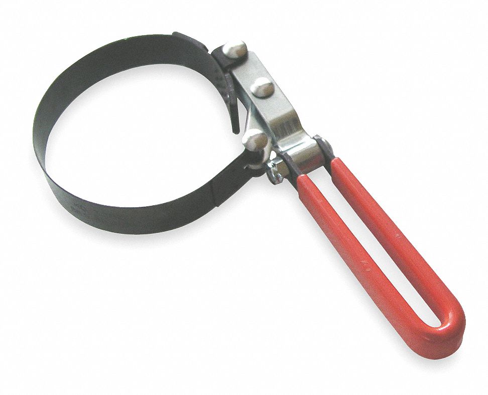

Originally Posted by acf6
I used a oil filter wrench that i use for my coolant filter, and put it around the big part of the cap. Spun it right off. cant really use it to put it back on though
i have the socket, and with two feet of cheater bar i couldn't get it to budge.. i would think that'd have alot more leverage than an oil filter wrench (unless i'm thinking of something different).

not sure if were on the same page, but this is what i used
i couldnt even try a socket though because it was rounded off, so i bought a new cap. i tried a big pair of vice grips and i couldnt get it to budge though

yeah thats what i was picturing. my cap is in good shape and the socket was holding, but that sumbitch would NOT budge.

Yea I mean even with the oil filter wrench I could only move it like 1/4" at a time and it was really tough to get off
That's what I used for years... I felt it worked just fine even with the front driveshaft in the way

Yea it worked fine taking it off, i just couldnt figure out a way to position it to put the cap back on, so i went out and bought a 36mm socket and it was alot easier
