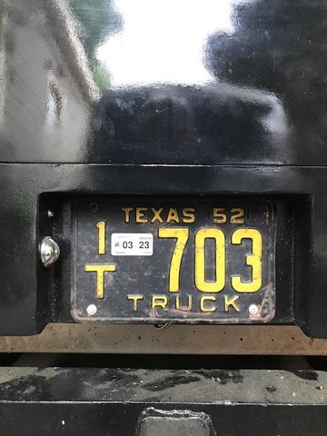

Got my 1952 Texas plate approved and have the sticker and the state inspection. I will post a though the windshield video as soon as I can get my wife to ride and video. I tried while I had a friend drive and did it all with the phone turned sideways. Of course the video is sideways and can't be turned so another will need to be done.

Ben, I wasn't sure but took my plate with me and yes they do. They have to check it out on some site and it took an extra 20 minutes, but I am glad that I got it. Here is the site: TXDMV.GOV - 014-12 Reuse of Previously Issued License Plates on Antique or Classic Vehicles

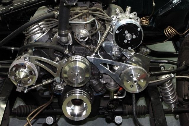

Any pictures Topper..?
I never even thought about taking pics of the bad parts but here is one of the system not long after I installed it several years ago.
