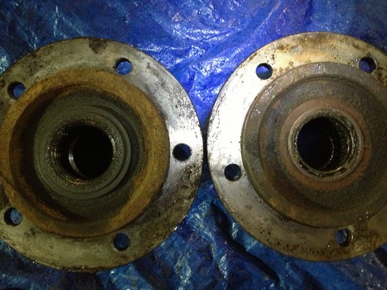

Took both hub/spindle assemblies off and compared them side by side. The only thing different/missing was the needle bearing/axle oil seal (pic below) on the passenger side. The one on the right is the passenger side, notice the rust colored ring where it no longer is and the absensce of ring on the left side where there is still a black plastic seal. I figured I had made my own little Einstien discovery. Well....no that was not it either.

There is supposed to be a needle bearing in the spindle, as shown in this diagram:
This is often neglected since you need to pull the spindle to get to it and it's pretty exposed even with the seal. The bearings are under $20 each, you can get them from most auto parts stores.
This should fix a good portion of the problem. The outer end of the outer shaft is kinda supported by the lockout mechanism, but the needle bearing really needs to be there to keep it all aligned.

I should mention that I have been driving around in 2wd with the hubs locked in, which keeps the axle shaft as close to centered as possible with all the gears being interlocked. I know this isnt great for the truck or idea for mpgs but it helps with the steering issue. When I had the spindle off I saw that needle bearing you're talking about. I put my finger in there and ran it around the bearing and it seemed to function fine and didnt seem to have any slop related to how it sits in there. I'm assuming to replace the I'm going to need a bearing puller or some similar sort of improvised device because it felt like it was pretty snug in there, but I didnt want to pull too hard in the wrong direction. The castle nut on the top ball joint on the problem side wasnt "loose", but it did have a little wiggle room so I took the pin out, tightened it a notch and now its snug, but still the joint itself has no play in it. Beneath the castle nut there is a toothed, angled or beveled washer, is this some sort of shimming/adjustment washer? I couldnt separate it from the knuckle so I just let it alone to save myself any unneccessary headache from ensuing

With that needle bearing, you could clean things up and put the outer axle through it and see how much play there is. Compare it to the other side. With the passenger side seal gone, I imagine that the bearing is probably toast.
National (made by Moog) part# SBK-5 has the bearing, spindle seal, and the axle seal...
