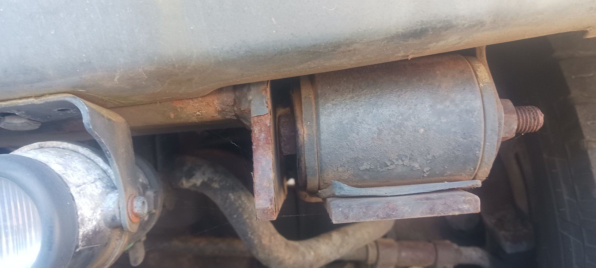

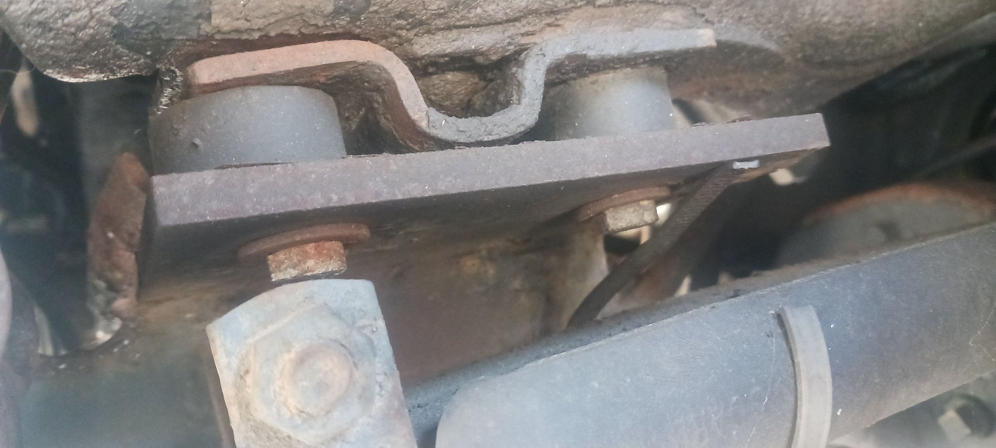

Okay finally got pictures.

Reese used to have a good selection of front hitches too, I’ve had those on several GM trucks, but never a Ford. None were through the bumper - all mounted to the frame and receiver was just under the bumpers.
Lots of uses for them. Winches, pintle, hooks, recovery, moving equipment, boats at Marinas, airports, industrial sites, construction sites, you name it. I used to use them often, and have considered modifying an old GM for one of my Fords.
You could look at a few snow plow mount pictures as well for good mounting locations if you’re looking to fabricate something.
