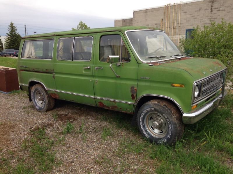

deposit on another van today, but its a former cube van. 176" wheelbase.
got it for scrap value basically, engine was seized from sitting, seller didn't know why it wouldn't turn over.
I wanted the 460 parts for my shorty, only 75-91 I have are diesel or smallblock.
when I pick it up on Friday I will post some pics, I will be cutting it up pretty quick, probably lift off the cab and cut the frame rails off at the trans crossmember. was a greenhouse/flower van so not much salt/winteruse.
too bad it was a C6, was hoping for an e4od. no complaints at $350
had to measure it and make sure it would fit on my trailer
found a pic from the advert I saved. ain't she a beauty
