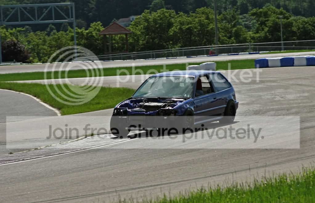

Coming from a hot rod/race car building background I am going to tell you something that many may disagree with.
The stock pump is just fine for anything!
See this 4 barrel carbed, bored, stroked, 12.5:1 CR, direct nitrous injected monster (lol), all running on a STOCK base model fuel pump (not even the performance model car).
Camed, bigger injectors, supercharged, bigger motor, STOCK fuel pump:
http://img177.imageshack.us/img177/7...ake2007kj2.jpg
Pretty much the same setup as the black car but with an even bigger motor yet and guess what, stock pump.
My grandfathers V6 buick also received a stock honda dx fuel pump after it burned up its original chevy pump (very very common problem with chevies).
I think your fuel pump will be just fine for anything you ever want to do with your truck.
