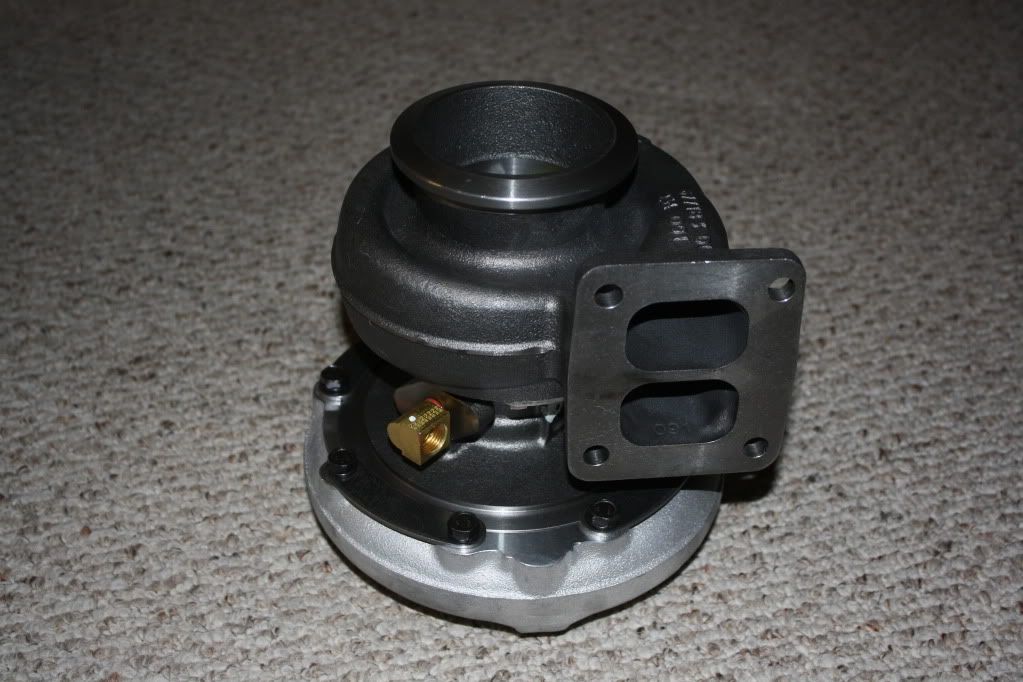

Damn that is sexy. Since you went with a T4 housing, will boost be limited by the amount of fuel then? What will you do if it boosts too high? External gate?

Also did the adapter come with it or did you have it made?

Originally Posted by oldblue89
Very nice, what does one of those go for? I can't wait to see its performance.
$1,100 shipped
Non gated, I don't think I'll be able to over boost.....
Had it made.
It is 63/68/.91 nongated T4. These are much newer more aggressive wheels than the 62/65 on the old charger. Better housings too.....

The more aggressive wheel and better housing is what made me think it might over boost a lil. I was thinking it would spool a lot better than that but I do guess on the other hand you had the wastegate on the other turbo disabled so you should be alright. I didn't think about that until now. Haha
As long as I'm under 40psi I'll be comfortable.... The thing with this charger is that it flows more air, at a lower boost, and lower drive pressure. non-gated chargers generally make more power.

what are the inducer and exducer for both wheels?
.91 a/r?

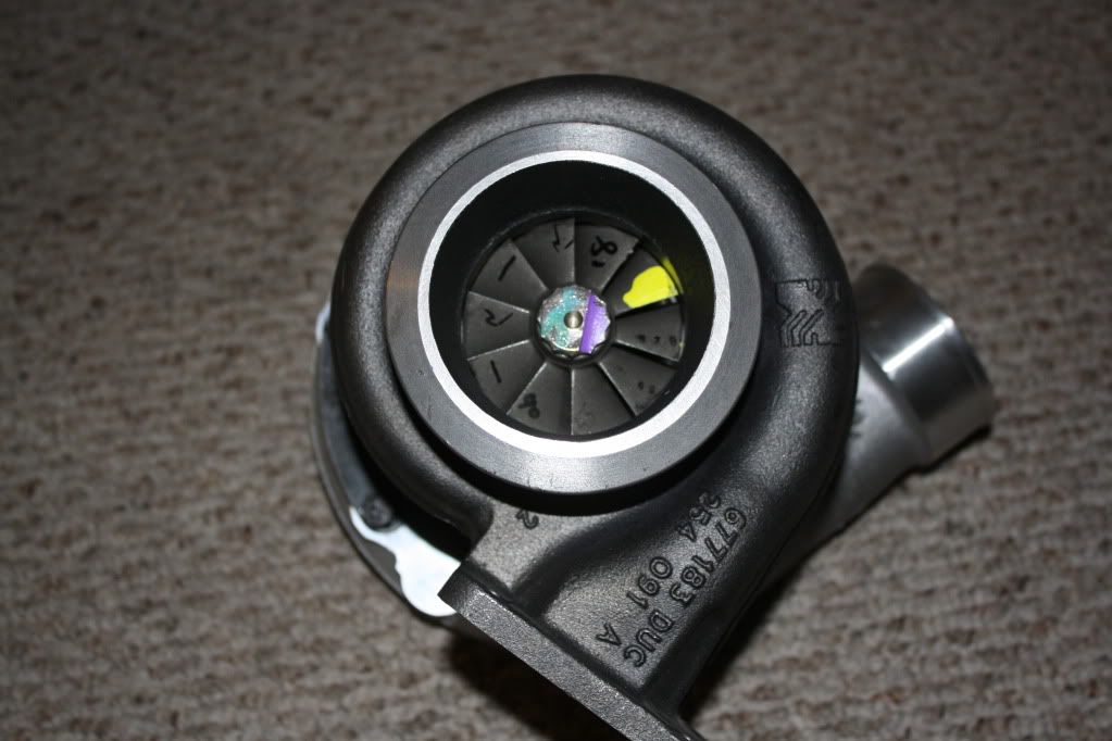

compressor is 88/63, turbine is 76/68.
compressor cover is 4" inlet, 3" outlet, .55 A/R. Exhaust is T4 twin scroll inlet, 4.21" outlet .91 A/R

so you sitting about 10mm over from mine and using a t4 housing
and I would be willing to bet these are much more advanced wheels on top of that.....I don't 100% remember which charger you had though... a garrett GT30 or something isnt it?
GTX3076r
i probably should have gone with a gtx3576r or gtx3582r but i was thinking that there might be too much lag (first time sizing a turbo lol)
IIRC the GT4094R or T04Z is what is compared to my new charger...
and what I mean by more advanced is the BW wheels are generally more advanced than the Garrett wheels. Extended tip compressor......J-hook turbine.... my turbine wheel spools like a straight cut 65, but flows air like a straight cut 71.
