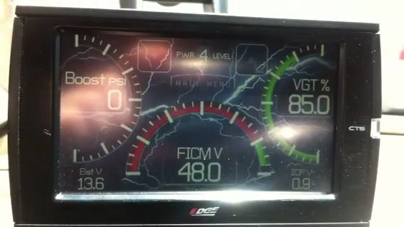

here is what your Edge CTS supposed to do
Accel Pedal Position, Barometric Pressure, Battery Voltage, Corrected Speed (03-04), Engine Coolant Temp, Engine Load, Engine Oil Pressure, Engine Oil Temp, Engine RPM, Engine Run Time, FICM Voltage, Gear with TCL, ICP Pressure, Injector Pulse Width, Intake Air Temp, Mass Air Flow, Mileage Coach, MPG Instant, MPG Average, TCC Duty Cycle, Time 0-60, Time 1/4 mile, Trans Temp, Turbo Boost, Vehicle Speed (04-07), Variable Geometry Turbo Duty Cycle
Check the Ones in bold post there values at
KOEO
Low Idel (truck Idel on its own)
High Idel (2500rpm)
Its a Start anyways something may pop up IDK

I don't think I'll do Injector Pulse Width but I'll try again

Boy I didnt see that Gauge hit over 2 psi Boost ever
IDK but if the Veins was stuck STILL would think you would get to 5-maybe 10psi Boost
are you shure thees not a MASSIVE leak somewhere in the CAC System that pushes the Boost into atmoshere

Its like your MAP sensor is DEAD
At 1 point you had 45% or so VGT% and 0 Boost
I dont think its the VGT more the MAP sensor being the Culprit

I've replaced it already. That was in park though
