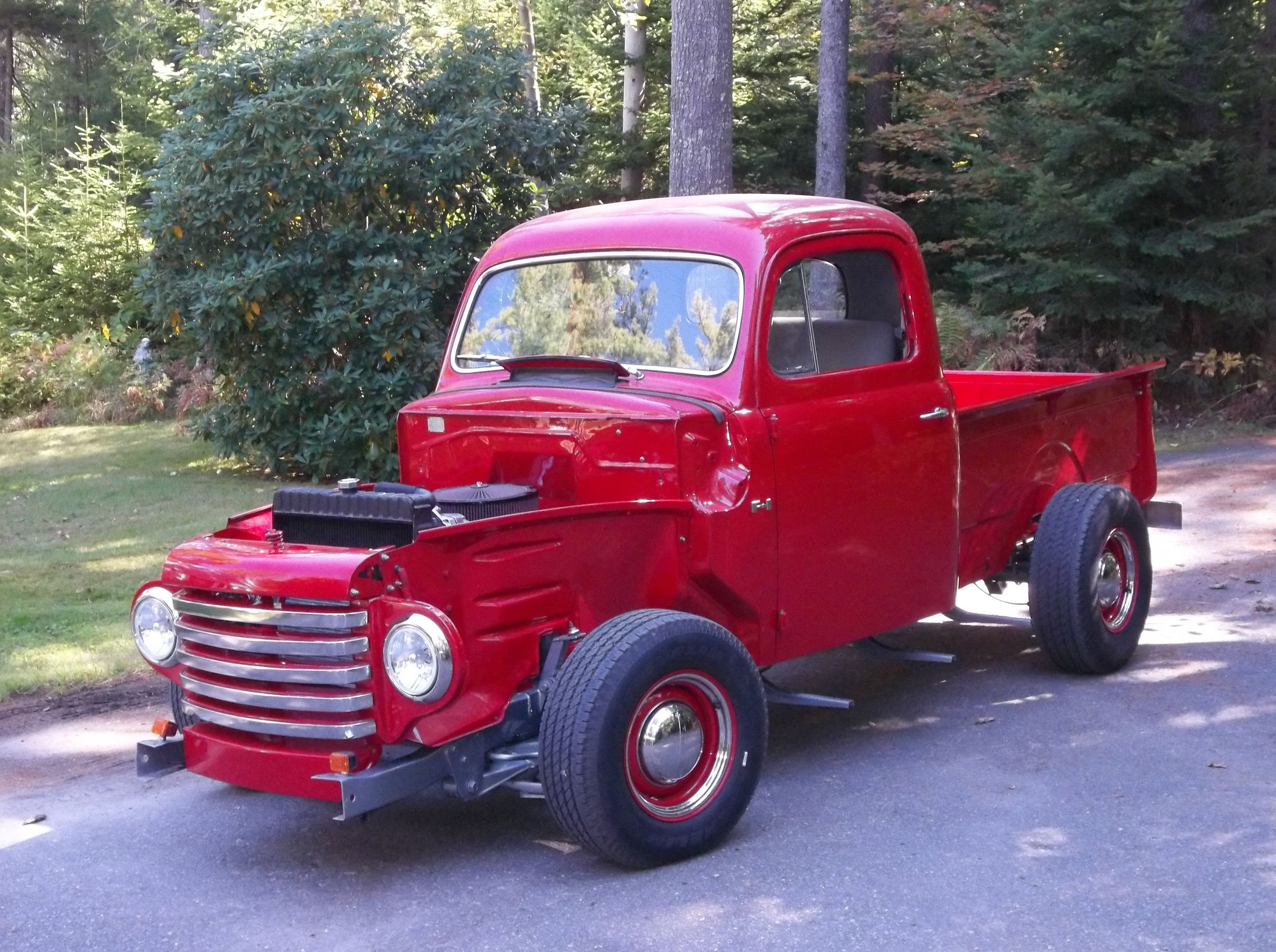

Your backup plan of diving it in primer this summer is the better plan. Based on my experience there is a world of difference between getting the sheet metal in primer and shooting color. If you want to use the next several weeks of class productively, take a fender or perhaps door and bring that to color ready and then re prime for summer use. IMHO the TV shows do a big disservice to what it takes to get into final paint, that is why it is so expensive if you have it done professionally. I spent the entire winter getting the front fenders, hood, rear fenders and running boards from "decent prime" to final color and assembled on the truck.
The 2 pictures above show the difference between last fall and now, about 4 months.
