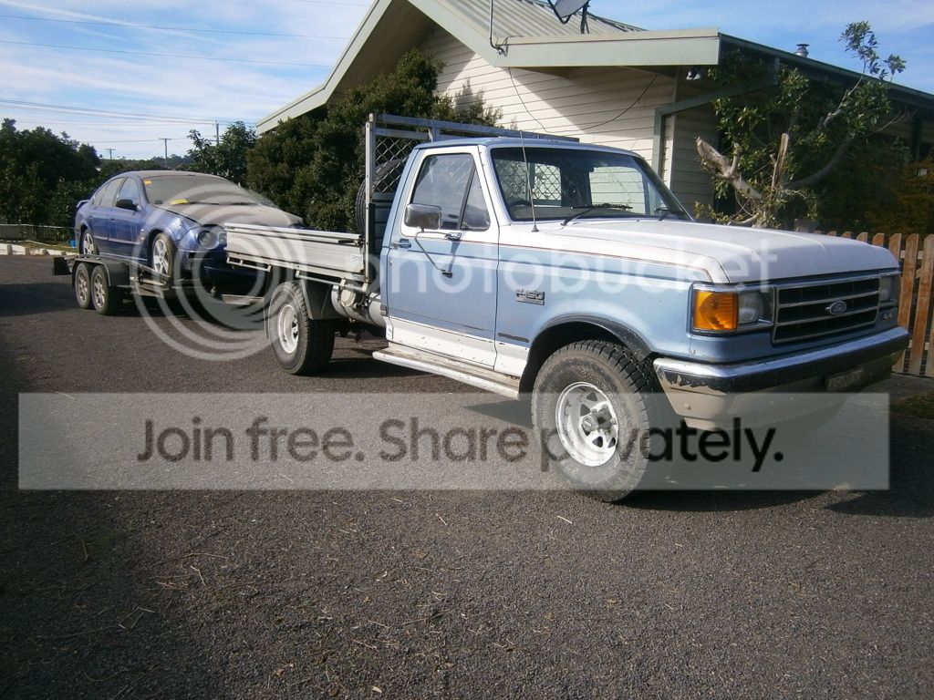

Put my truck to work for the first time on Friday. Got rid of one car on the way down and picked up another. About 200k's round trip. I have to say I was impressed, loads of torque and pulling it was no effort to the big girl. Taking off at some sets of lights did result in some tyre squealing and lots of turning heads, needs an LSD centre or something along those lines. But other then that she never missed a beat. Got to say I like my new truck!

Excellent stuff Ash. Glad its working out for ya bud. Whats the deal with the AU. Another project ??
Old May 21, 2012 | 06:48 AM
  #57
AshCook's Avatar
AshCook
Joined: Apr 2012
Posts: 61
Just a bit of a hobby and also makes a little pocket money to spend on my cars. I'll pick up a damaged car here and there for some bits I want and sell the rest. This one is a stat write-off, had a hit in the front left. But it is a 5 speed car so a few good bits included.
