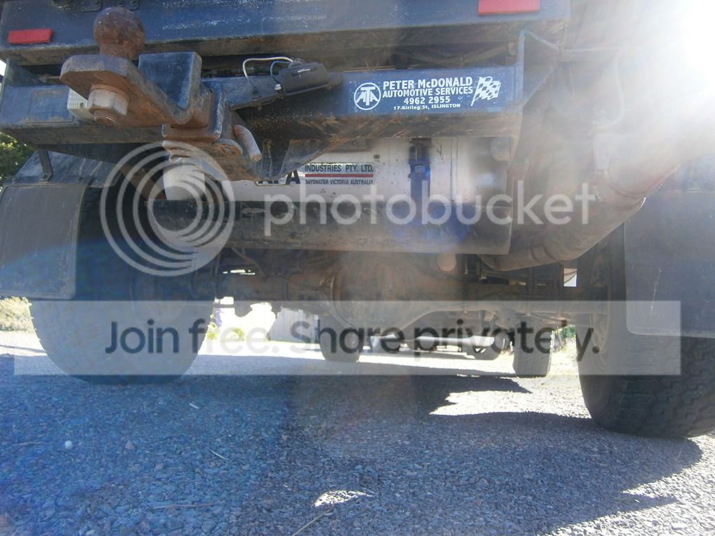

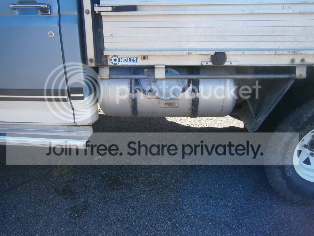

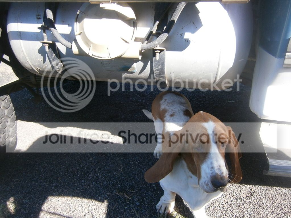

Now for the LPG shots. Here are the tanks
And more help

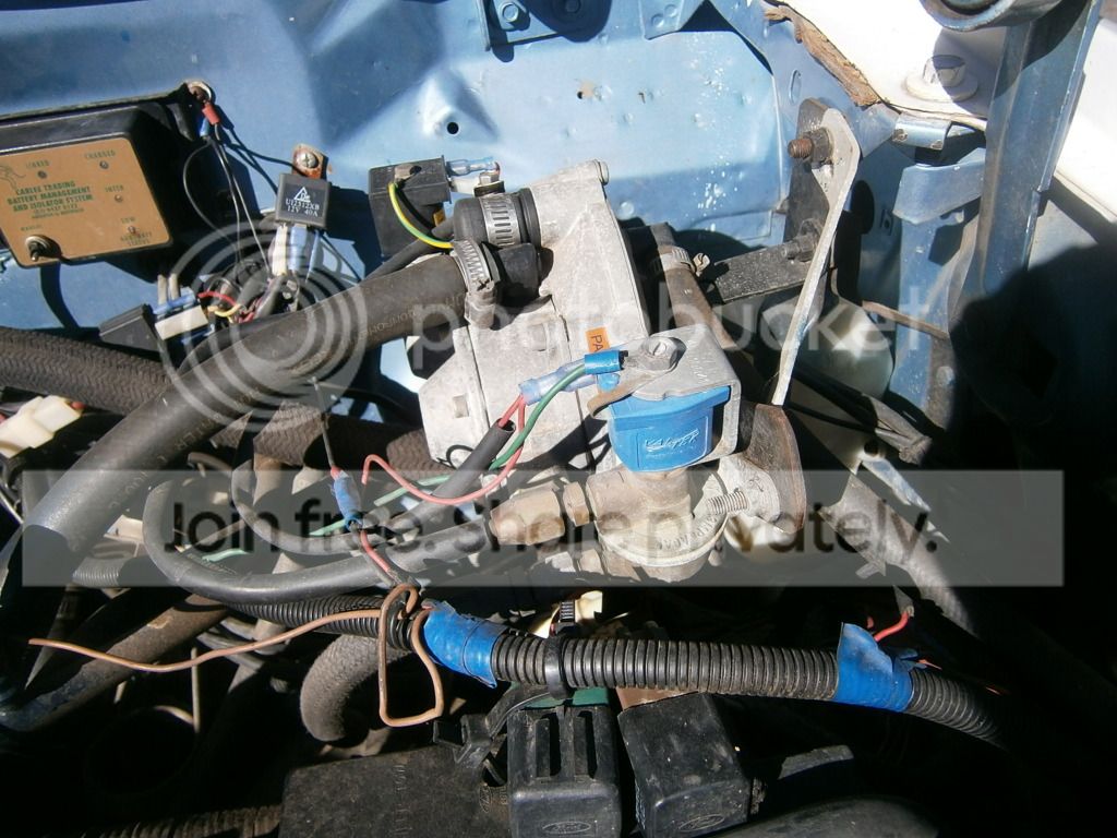

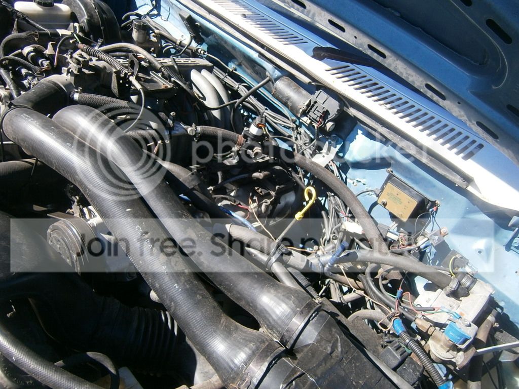

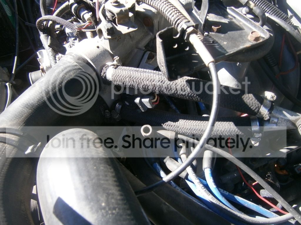

Here is the system in the F150 engine bay. You can see the converter on the far right, the lines going from the converter and splitting into two where they go into a mixer in each of the intake pipes
The converter
The mixers. This is a big bottleneck and a big con to this system. It reduces the ID of the intake pipe drastically and really chokes it. It effects the performance of both LPG and more so petrol

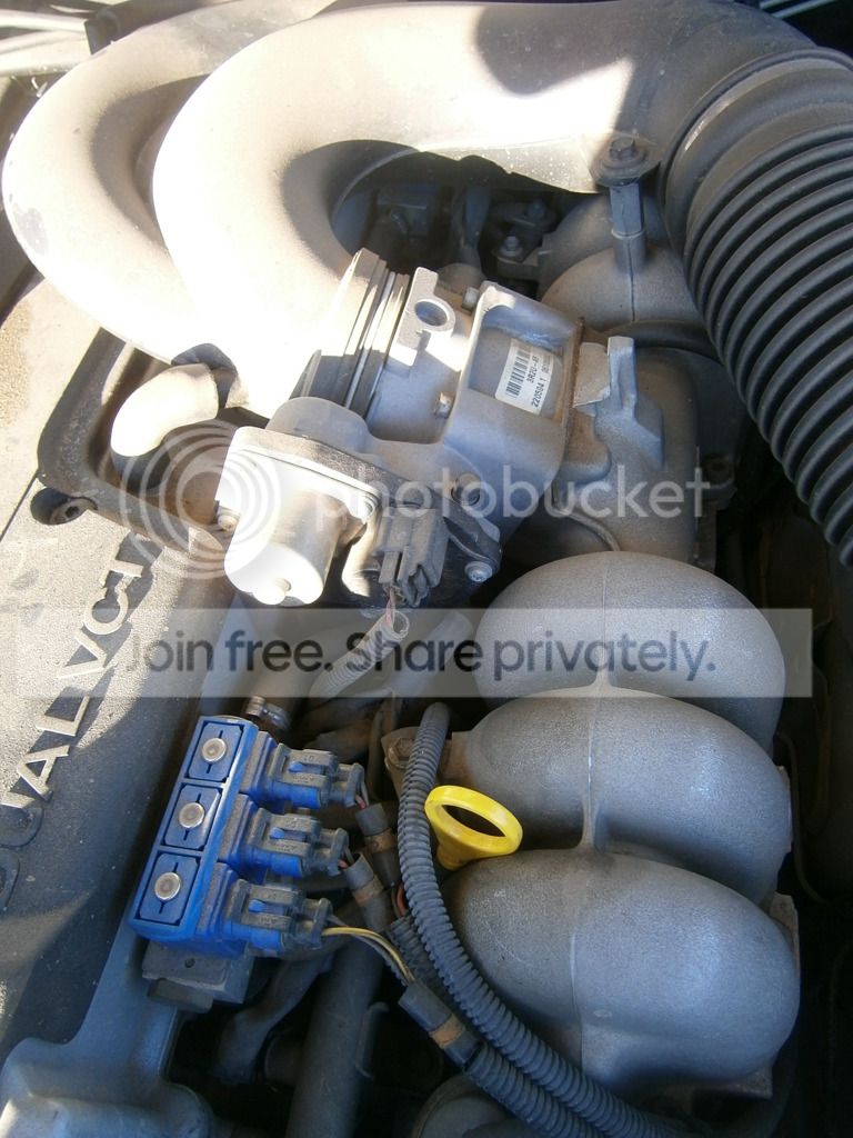

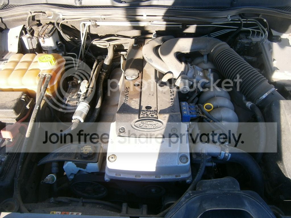

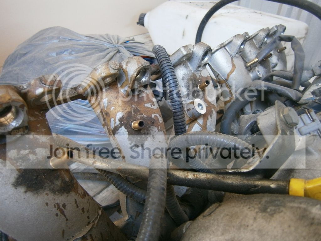

This is the OMVL injected system which is on my 6cyl Ford Territory. It is the same system as to the one I will be putting on the F150. You can see it also uses a similar converter to the left. With the V8 it has the option of running twin converters, one on either side of the engine bay, but that is more so for high HP engines. I think that would be overkill for the trucks engine.
Here are the injectors, a very neat fit. They are group on 3's for the 6cyl, that's why I needed groups of 4 for the V8.
And this is a manifold with the brass nozzles where the injector piping attaches to. Compare this to the older mixer style in the intake, this injected system has no bottleneck and no restriction in air flow.

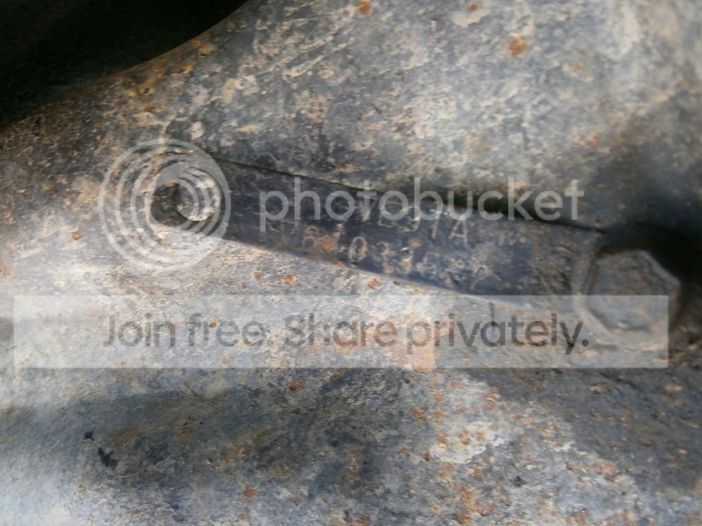

From the link supplied, I found my front diff reads as
610335-2 - Trac Lok - 3.54 - 88.5 - 92 1/2-ton
Found the break down here
1983 Ford Bronco Diagrams picture | SuperMotors.net
