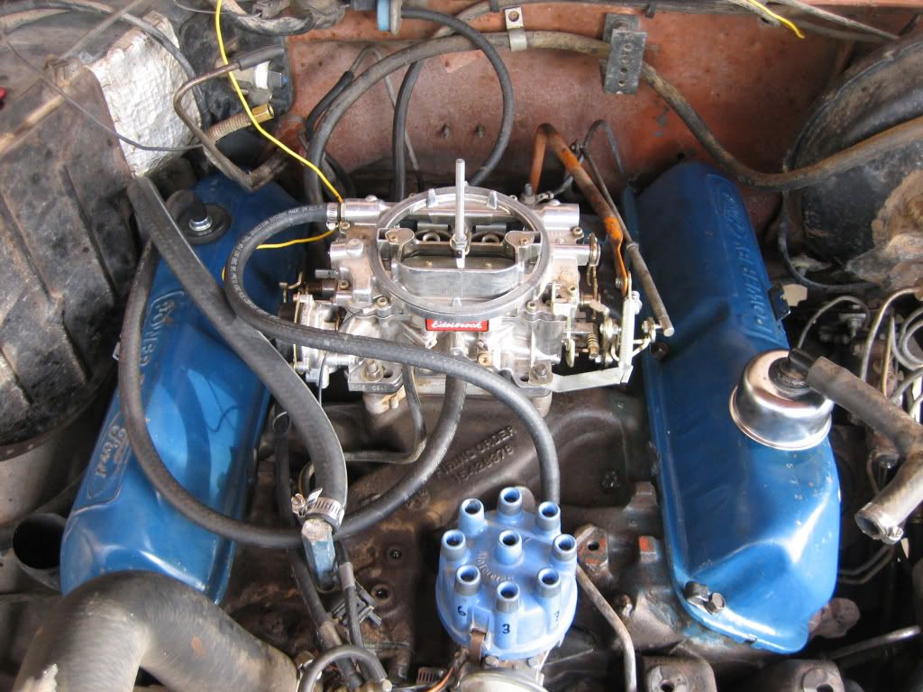

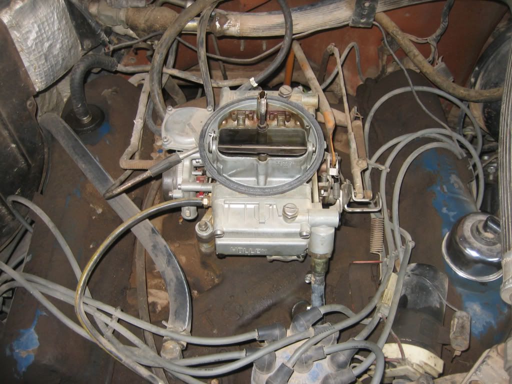

This entire weekend was consumed trying to clean the motor. It was filthy when I bought it and I hadnt had the will to clean it till i had to scrape away some muck to get at the dizzy for adjustment... then it snowballed into replacing the leaking valve cover gaskets. 3 cans of degreaser and a couple worn out scrub brushes and I was able to uncover part of a motor in that dirt pile.
Before
After
Unfortunately, the wiring leading to my coil was just aching to break apart, leading me to a new problem that I outta be able to fix with some solder and new harnesses...
Before
After

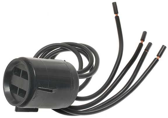

I can't tell what the plug on the left looks like. LMC may have something you can use? Otherwise numberdummy may be able to help!

So napa has the female end of the connector (below), but I need the male end...

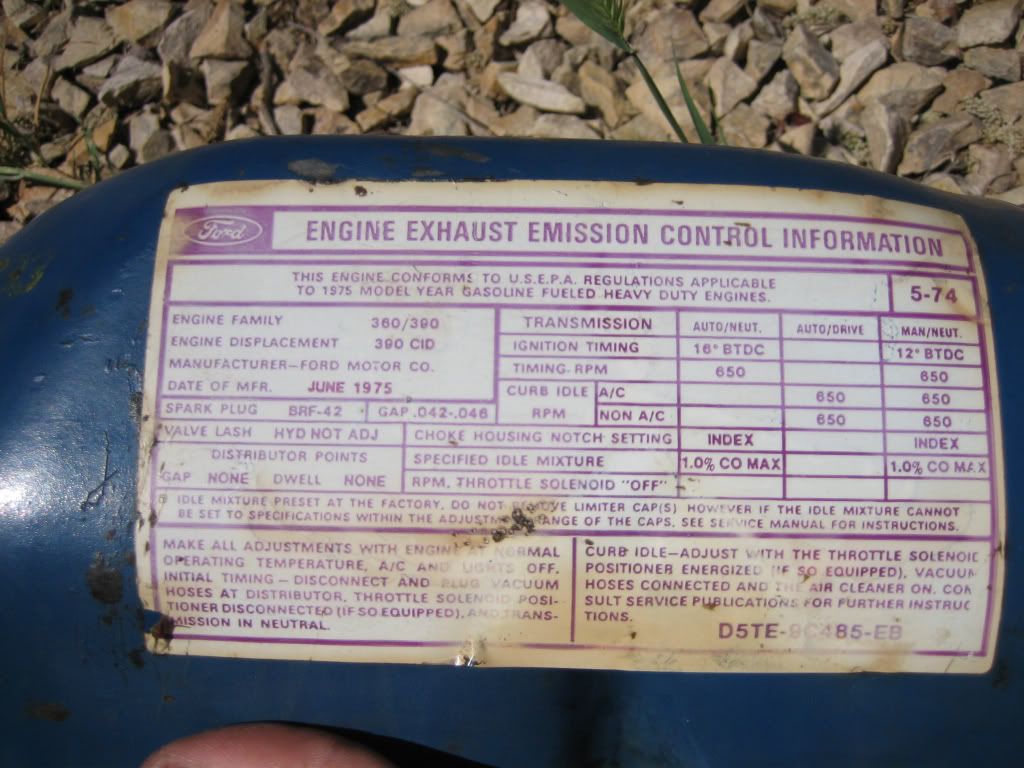

Problem seems to be solved... engine degreased, new valve cover gaskets (please dont leak!), A/C system removed (hopefully to be replaced with a sanden soon), and new wiring to the dizzy and coil just to change the timing a few degrees. talk about a snowballing project.
So I got the motor timed to 16* BTDC as listed on the emissions label on the valve cover and the problem seems to have been solved.
seems like most of the FEs are timed between 6 and 8. Any ideas why mine is set at 16? I dont think the truck was a cali truck (although it was made in San Jose). I cant see any evidence that it had any emissions junk (i.e. no egr etc.), plus Im pretty sure it was purchased new here in NM, where we still dont have emissions laws (except Abq)
Would factory A/C require this timing?
