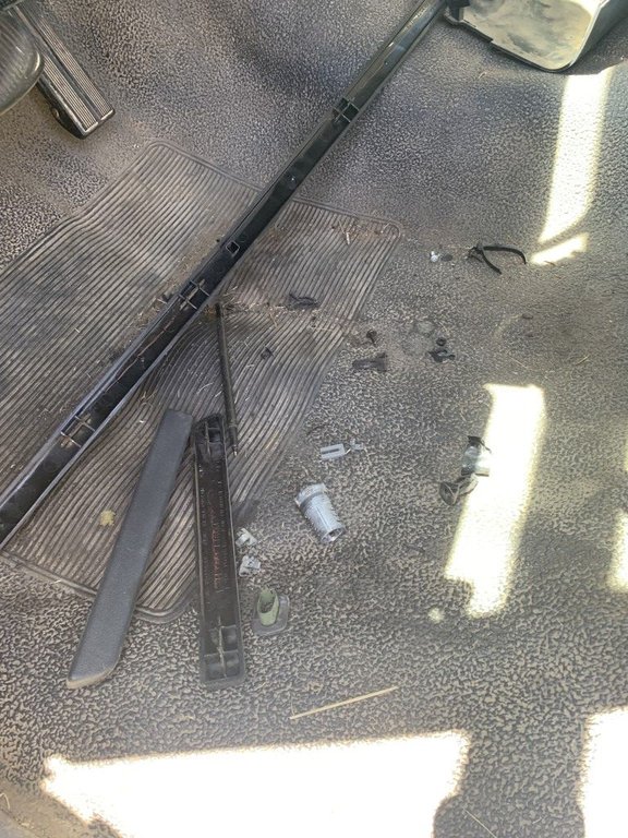

I am super happy to get everything working, I took a couple boxes down and strapped them on the flatbed with a tarp over them.
I need to jury rig that shifter cable, where the plastic nut is which I've lost. Unfortunately it wasn't in my floor of shame...
To be fair to myself, I got replacement short pieces that go on each side of the steering panel, and I think I can use some of these
small metal tabs that broke to reassemble the long piece (it was already broken, I just removed it so it didn't make noise). There's
a few tabs and such in the floor of shame...

Ok, you guys can probably relate to this well...the interior is falling apart, when you try to take stuff apart it breaks tabs and/or plastic,
so you ponder..."self, what if I replace it?". Then you look at used truck prices and people are asking $20k-$25k for anything decent. And
then realize that a new truck to replace it is like $80k. To be honest, I'm not wanting to spend even $25k on a vehicle. I bought a new
Toyota Previa in '92, it costs $28k fully loaded. It was the last new vehicle I ever bought.
