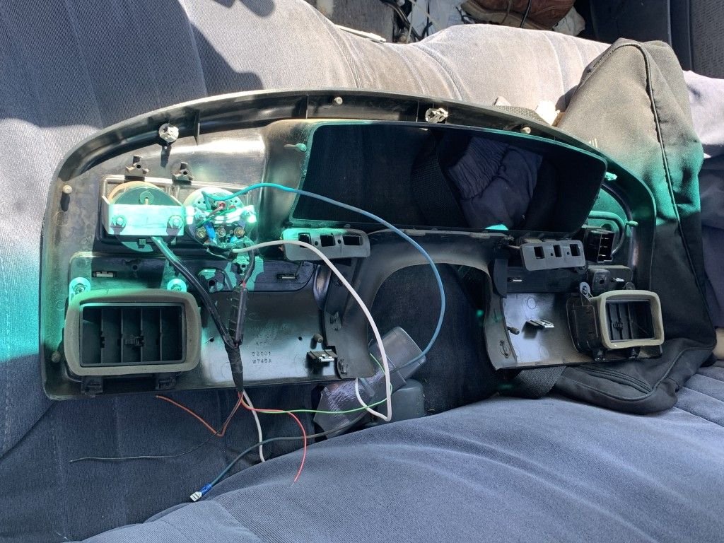

One thing to note. The dash I got was from an F-250 HD, and has a tach and water temp.
Not sure if they make a false front for it, but my dash doesn't have them and there isn't a
way to remove the cover AFAICT, so plan to leave the gauges there, and I coiled the wires
up and will leave them behind the dash.

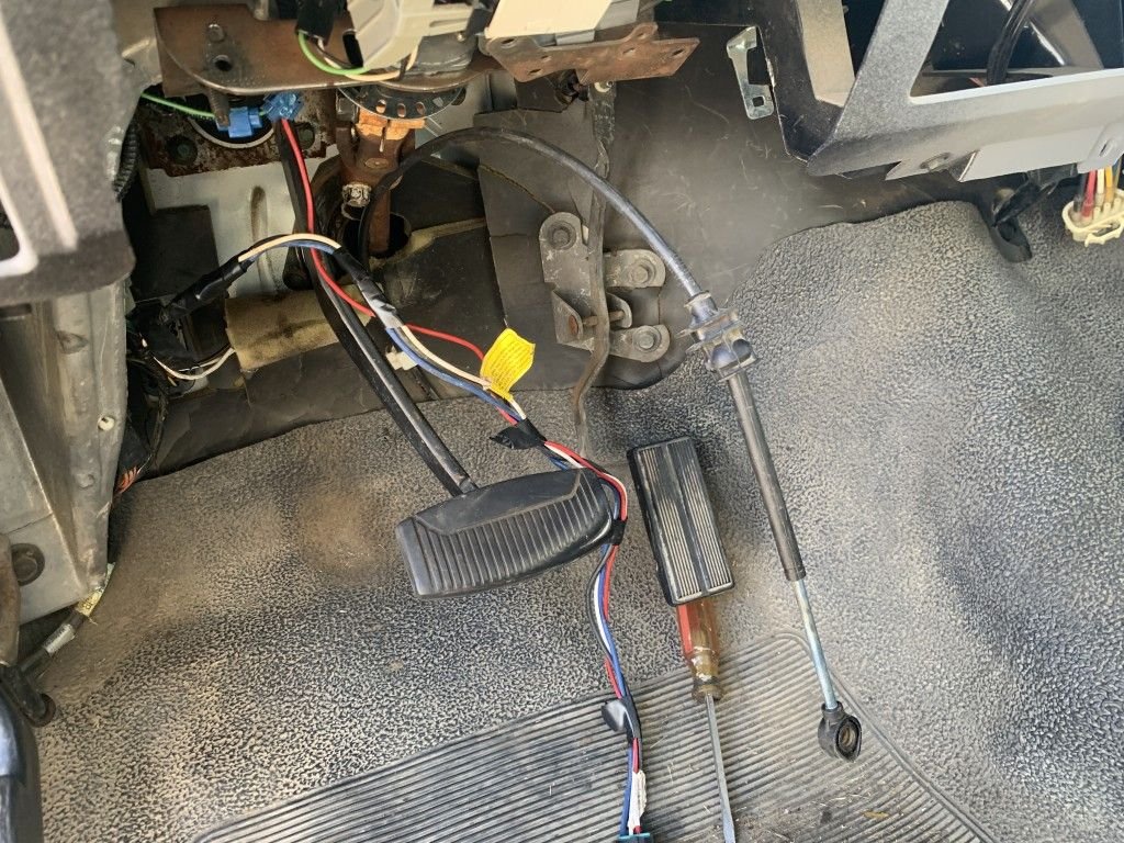

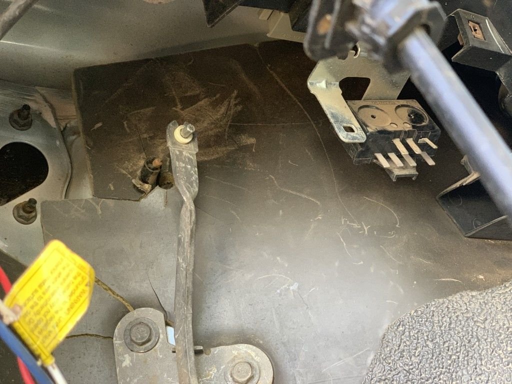

@manicmechanic007 I just got back from the yard where my truck is. I can't figure that out for the life of it. In reading
your reply, I could be on the wrong side, that it might be on the left side. I agree, it seemed to be like that previously, but I did
check both sides to see if something was approximately the correct length. There was one standoff for a screw, not sure if I knocked
it off or broke it, but there is not screw in it. I am not sure how the connector would work with a screw though.
I took some pics, but it's hard to get any video as it's so close under the dash when I get my fat **** in there...this is
really stumping me...I seem very close to fixing this, but no cigar until the cable to fixed to something.
Alan

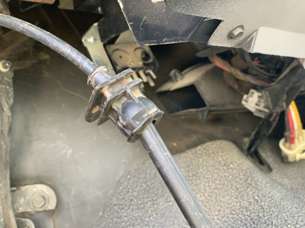

Could this be where it connects?
This is what the cable connector looks like.
length wise it looks like it could attach to that aluminum or the steel above.
I don't think this is the bracket, but it seems like the correct distance, not sure.

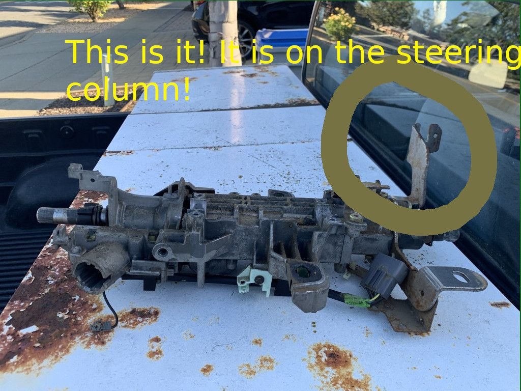

Wait a second...found another video. This shows a '94 going to the left side, this is my cable.
See 2:16 in the video. Not sure if I have that on the left side, but it must. I have that pin on my
cable connector, so that is definitely what I'm looking for. See pic below as attachment.

Holy flock, I just figured it out, the connector is NOT on the dash, but it is on the steering column itself.
I have one more check to do. Since the newer one routes from the right side with a bracket under the dash,
I need to make sure I have the correct column. I'm guessing I don't have that bracket on the rebuilt column,
but will find out tomorrow. I promised my wife I would go walking with her before it gets dark...
The 2nd pic below is the rebuilt column, it looks like it has it, but you can't see the end of the bracket. The
original had 3 of the same brackets on it. I think I'm good to go once I get down there.

Wonderful!
That is what I was trying to say
When you remove the column, you have to remove that cable from its bracket because the bracket comes out with the column
You should be all fixed up and shifting okay now, right?

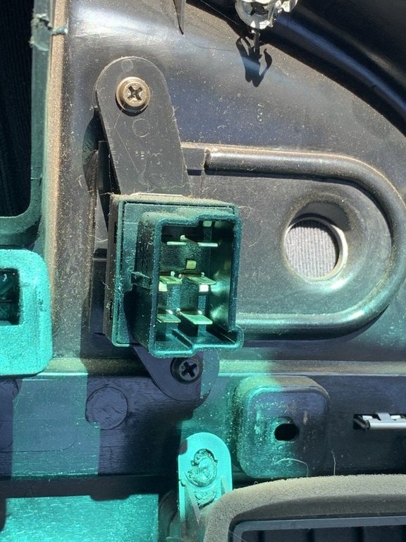

The biggest problem is that the cab light now stays on, and I suspect it could be the door jamb button, I have seen them go bad
where they stay off and the light never comes on, but I suspect it's possible to have like I have and the light stays on. I can remove
the light so that it doesn't draw any power, but think O'Reilly's Auto might have one cheap.
