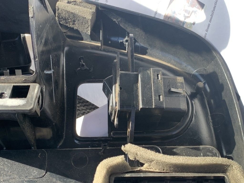

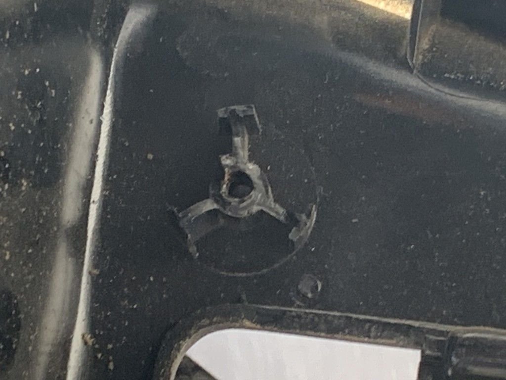

Well, I thought I broke some plastic tabs, but I pooched myself yesterday as the standoffs broke off that hold the fuel tank switch to the dash. There was two small screws holding it in from the rear, but I seem to have broken both of them (top and bottom).
There are 2 ways I was thinking about jury rigging this to get it together. I should add, it seems to work properly. I need to take it back apart and the transmission seems to have gotten disconnected. I did put the small cable loop over the dome to the top right of the column, but it is not connected now. I am not sure, but I seem to have lost that little plastic nut that adjusts the cable, maybe that is my problem??? Does that make sense to anyone? As far as the ignition, all of that works correctly, but I don't know if I'll need to take the ignition cylinder out again or not.
The 2 ways I thought about. 1) just drill through the dash and use a metal bolt and nut with the nut behind the fuel tank switch. Short of super glue, I'm not sure how to resolve that without getting a new dash section. The 2nd way is to super glue some standoff tubes that are threaded. Have any of you done this? The wires are not very long at all, but I see the connector comes off now...there's always some hindsight after the fact...LOL I guess the dash didn't like hanging on those wires...
Alan

i would try the glue first. as for the shift indicator, if you do not have the adjuster in there, it will not work

Use some good epoxy and glue the switch to the cluster surround / bezel
I would also take a file to the connector retainer and remove some of the tab
That will make it unplug easier next time, and maybe not break your glue, if you need to remove the bezel again
Have fun

Yeah, I think I will try the glue route.
I tried calling some salvage yards to see if I could find a dash bezel that surrounds the speedometer, but it's not so easy. I have a dual tank, and some don't have the tank switch on them to begin with.
I also see blk, grey and brown. I need grey, but blk would work.
I don't think I'm going to work on it today, but if I do I'll have some gorilla super glue with me.
Alan
