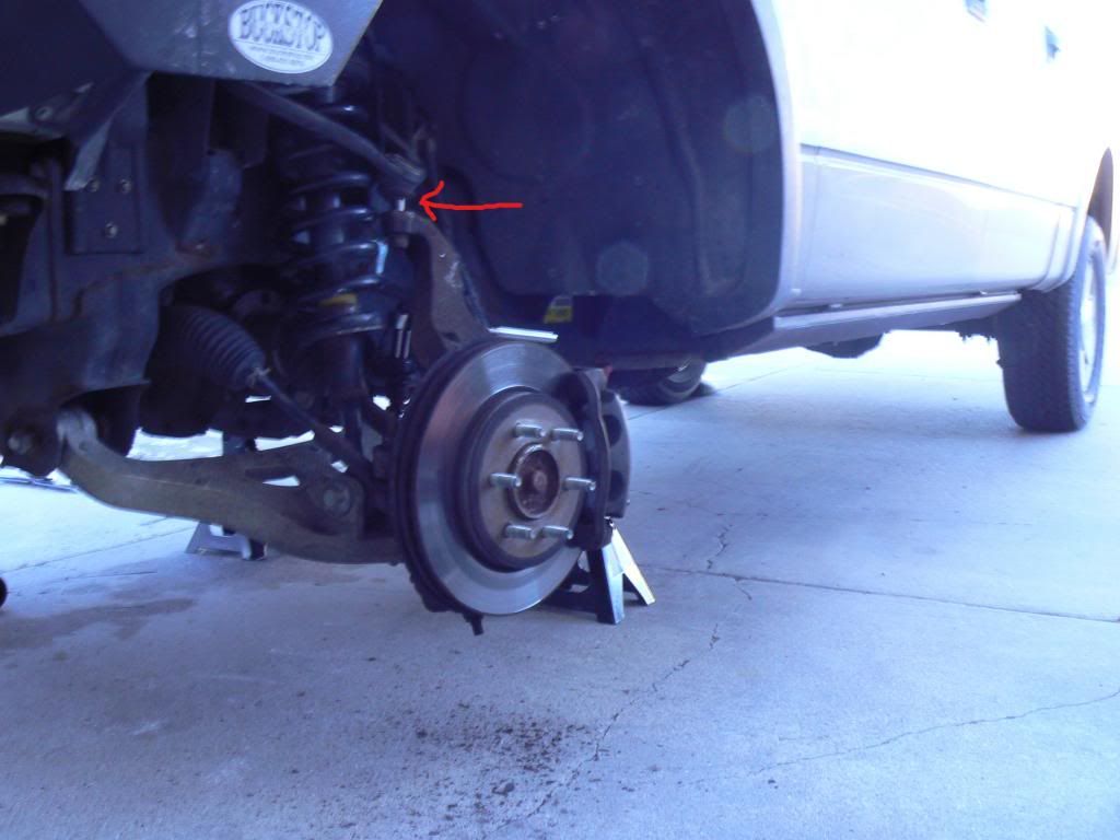

I put the leveling kit it today and ran out of daylight before I could take the "after" pics. However, I am having a small issue that is stopping me dead in my tracks for calling the truck not only done but safe to drive.
This bolt on the upper control arm is just spinning when I try to tighten the nut down. It is the only one that is giving me any issues. The nut will only go on as far as you see in the picture so I'm pretty certain it's not safe to drive as it is (unless I'm taking it to a mechanic).
I'm at a loss and figured maybe some of you smart people can help me figure it out.
Once I get this part fixed I'll get some before and after pics posted so you can see the results.

Bobbie, the bolt is still attached but spinning in place? That ball joint is incorporated into the upper arm and cannot be pressed out. Moog makes a replacement upper that has a press out joint if you end up having to go that route. I'm wondering if the joint itself has lost integrity.

After much chat with the some much smarter people than me I'm taking a trip to the autoparts store today for some replacement parts. There are a few things that I'd like to replace from doing this level that I may as well do it now anyways.
Will make for a better ride and safer in the long run.
I'll post pics up when I'm done. Hopefully later today or tomorrow.

All in all I felt like I did the leveling kit twice. Once on Saturday to install it, and once again today to replace the upper control arm. I can't for the life of me get the tie rod end bolt to losen up so I'll take that to the alignment shop and have them replace it along with the sway bar link when they do the alignment (I know that's really easy but the part isn't in yet and I'm not taking this damn thing apart again anytime soon).
