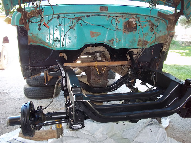

Here is a pic of a 63 4wd F250 frame where the cab would sit. You will see the two front cab mounts. This is pretty much the same frame that your 65 4wd will have.
The cab mount on the drivers side is the frame bracket just behind the shock tower. Your 2wd cab will not mount onto this bracket as the mounts come off of the front of the cab.
Under the 4wd cab with the step that was mentioned previous there is a cab floor brace and cab mount brace that sits into these frame mounts.
If you will look just to the left of the 2x4 in this pic you will see where the cab on the 4wd mounts. This is completely different from the 65 or 66 2wd cab mounts.
This is the inside step cab that NumberDummy was talking about.
