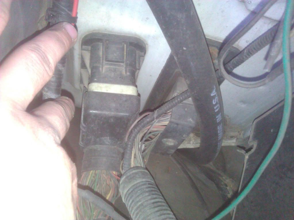

Is it a bulkhead connector through the firewall or multiple pigtails? A photo maybe in the meantime? Will be tomorrow afternoon before I can get over to the shop.

It's a bulkhead connector through the firewall right next to where the EEC connector is on the firewall. I'll post a pic in 20-30 minutes when I get back to the shop.

Here's the pic just to make sure we're talking about the same connection. The EEC is the connector on the right, the one I need is on the left. PM SENT!

If the one I sent doesn't look right let me know. It's the connector with the wipers in it.
