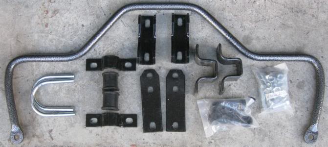

Out of the box. First step: inventory the kit by pre-assembling each of the four attachment points.

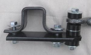

Arm clamp and end link.
Axle U-bolt and bushing.
The kit did not come with goo, so I used some out of my inventory.

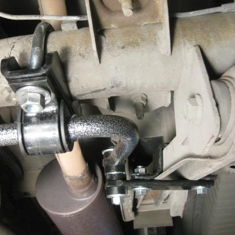

Installed. I'm getting with the factory on longer U-bolts.
It seems I'm not the only one who came across the U-bolt issue.

Here is a follow up on the U-bolt issue. It was slightly annoying to discover that nearly ten years after this was flagged, a kit was delivered with bolts too short to reach around the stock 7.5 axle. One call to customer service quickly got something that worked, but a little too long and thinner than what was originally in the kit. I'll need to cut the bolts back before they find a rock or road debris.
Orignally kitted: 4-3/4 long, 1/2 thk. Too short, doesn't work.
Replacement: 6-1/2 long, 7/16 thk. It gets the job done.
Ideally: 5-1/4 long, 1/2 thk
