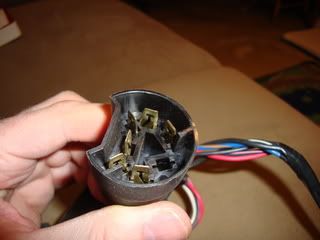

Ok.....I know I'm going to get beat up on this but I looked and didn't want to resurrect an old thread.....so here goes. 65 CS with 2 speed wiper motor & 4 prong switch. Seperate washer button and the switch is starting to go. I tried cleaning contacts and connections and it still acts up. So I got me a delay setup off a mid 70's ford Bronco/Pickup.
Here's the switch
This is the connector to the wiper motor/washer pump
Can I just use the switch without replacing the wiper motor?
If so what are the pinouts on both switch?

The shaft is modifiable to accept the slick ****. Use the wire and plug to mate up to the wiper motor wires. You can figgure this out by using a multi meter on contunity.
I used the late model switch the harness to the delay and out of the delay to the wiper motor. Dont remember what pins went where but i worked it out using the multi meter.
As long as your existing motor is 2 speed it will work.

The new intermitten switch has 6 connectors were mine has only 4. This intermitten switch also has the washer button built in to were mine is seperate, so i suspect the other two are for the washer. Just need to figure out.
Everything I've read so far talks about replacing the wiper motor with a newer 70's motor, but none talk about using your exsiting motor (which mine is a 2 speed motor) with the intermitten switch.

Pat I used my 76 donors motor, swapped the arm on the back of the motor for correct parking, and everything else was plug & play. Been working about 12 years now.

This is what I found out about the wiper motor, you need to get one from a early to mid 70's truck because it will have the right connector you'll need to plug the the delay switch into. Ours only has 4 wires (65 f250 2 speed wiper motor ) and not the right connector. If you go to lets say Rock Auto or O'Reillys the picture will show the right connector for the switch, but you might have to change the arm on back of the motor for park just like jowilker stated. Sorry to say I never got around to doing this mod because someone really wanted the truck and made me an offer I just couldn't refuse. Good luck !
