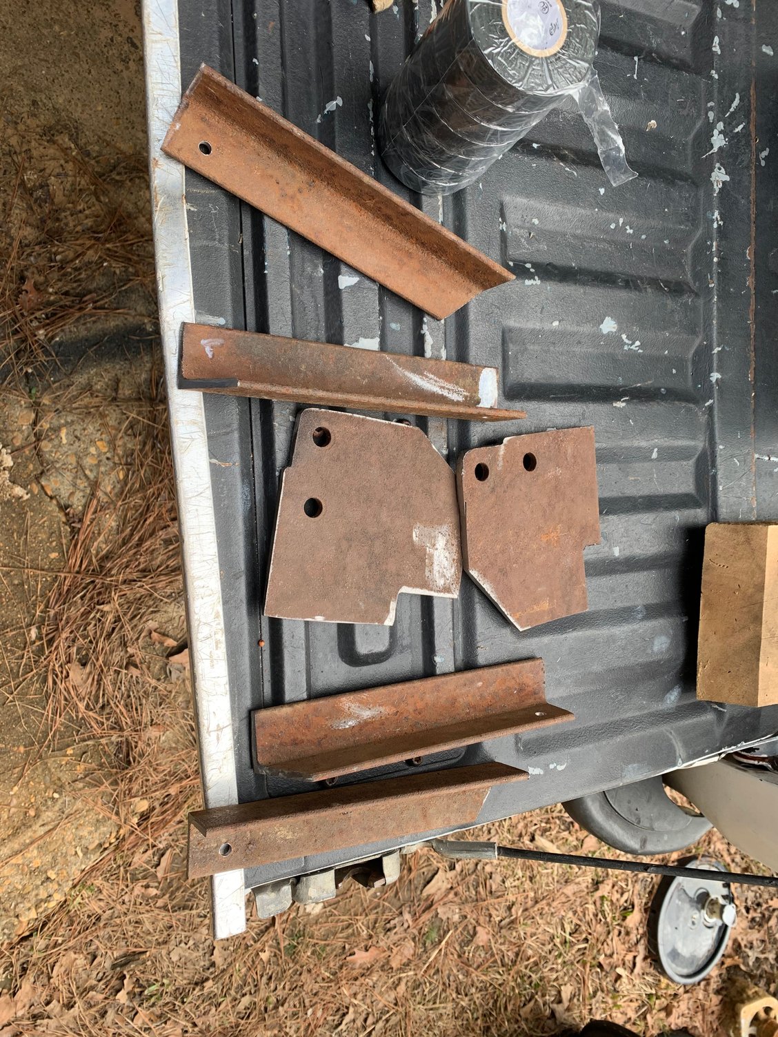

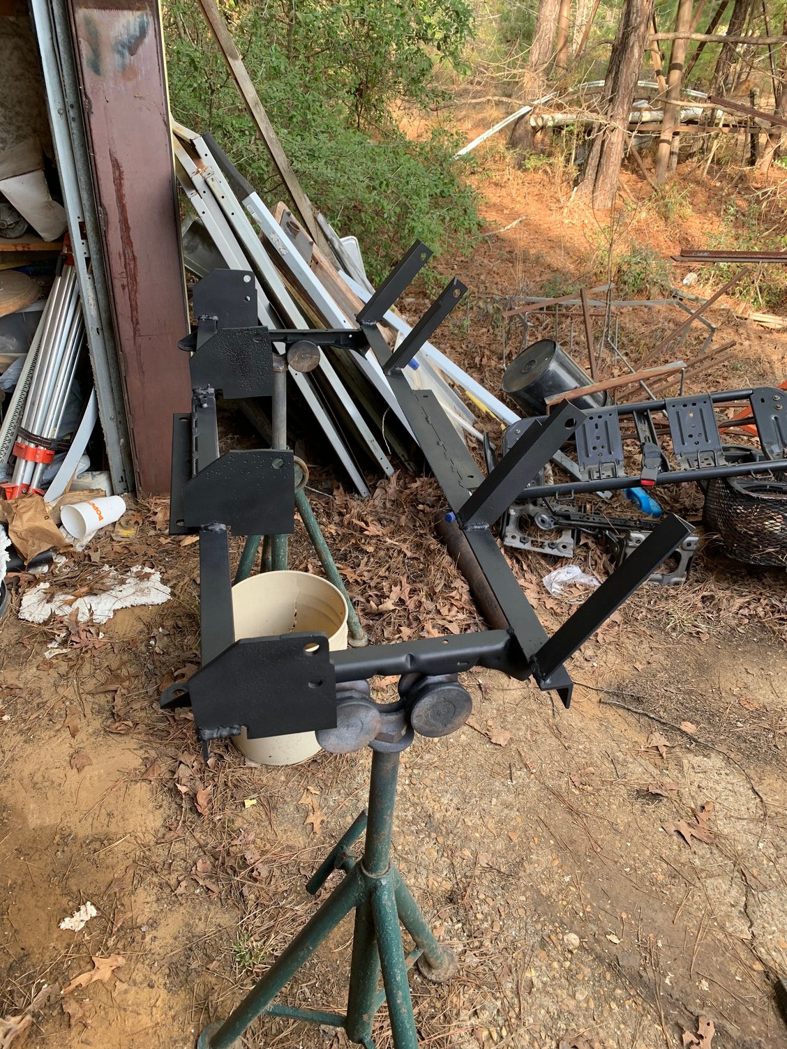

I got my king ranch seats for $375 out of a junkyard. Mine came out of an expedition and have required lots of surgery so far...
I still have the fronts to do which require more surgery. I recommend getting you seats out of a pickup instead!
