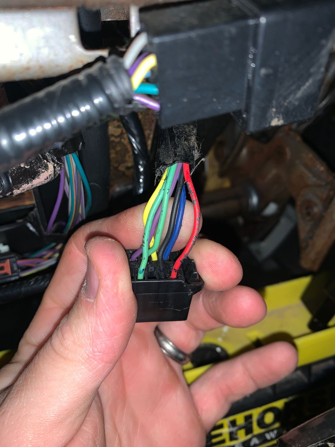

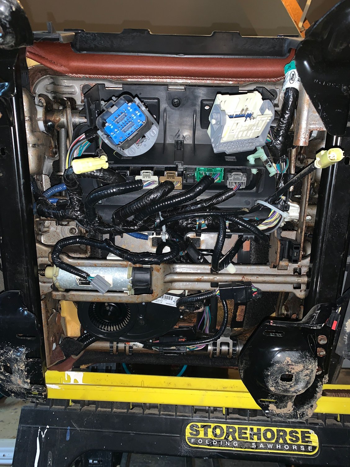

I’m gonna swap some 2008 Ford Expedition seats into my 97 OBS. I can’t find anything on these seats anywhere... Can someone help me identify the airbag wire/plug?
I want to make sure I have that disconnected before I apply any power.
Second question. Does anyone have the schematics for the climate control (heat/air)?
there are 7 wires entering the blower.

Jeebus theres alot going on under there on that seat. Hopefully you can find a harness.
Im looking forward to seeing them installed!

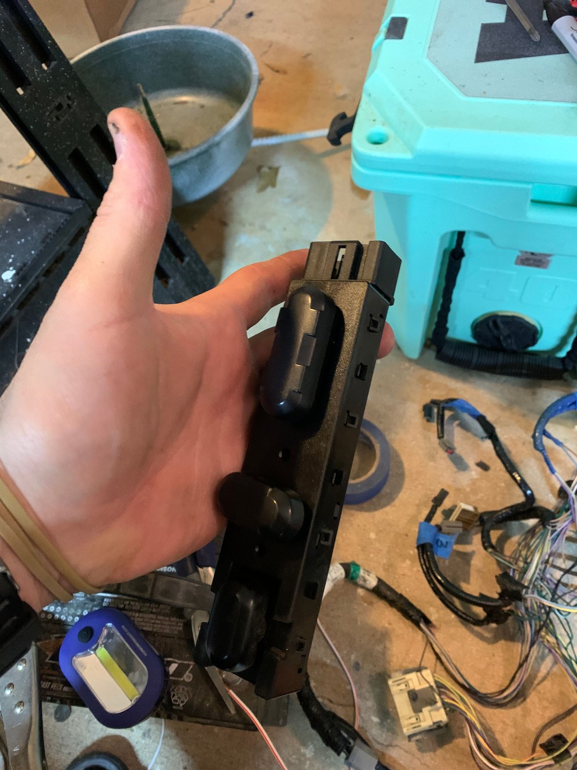

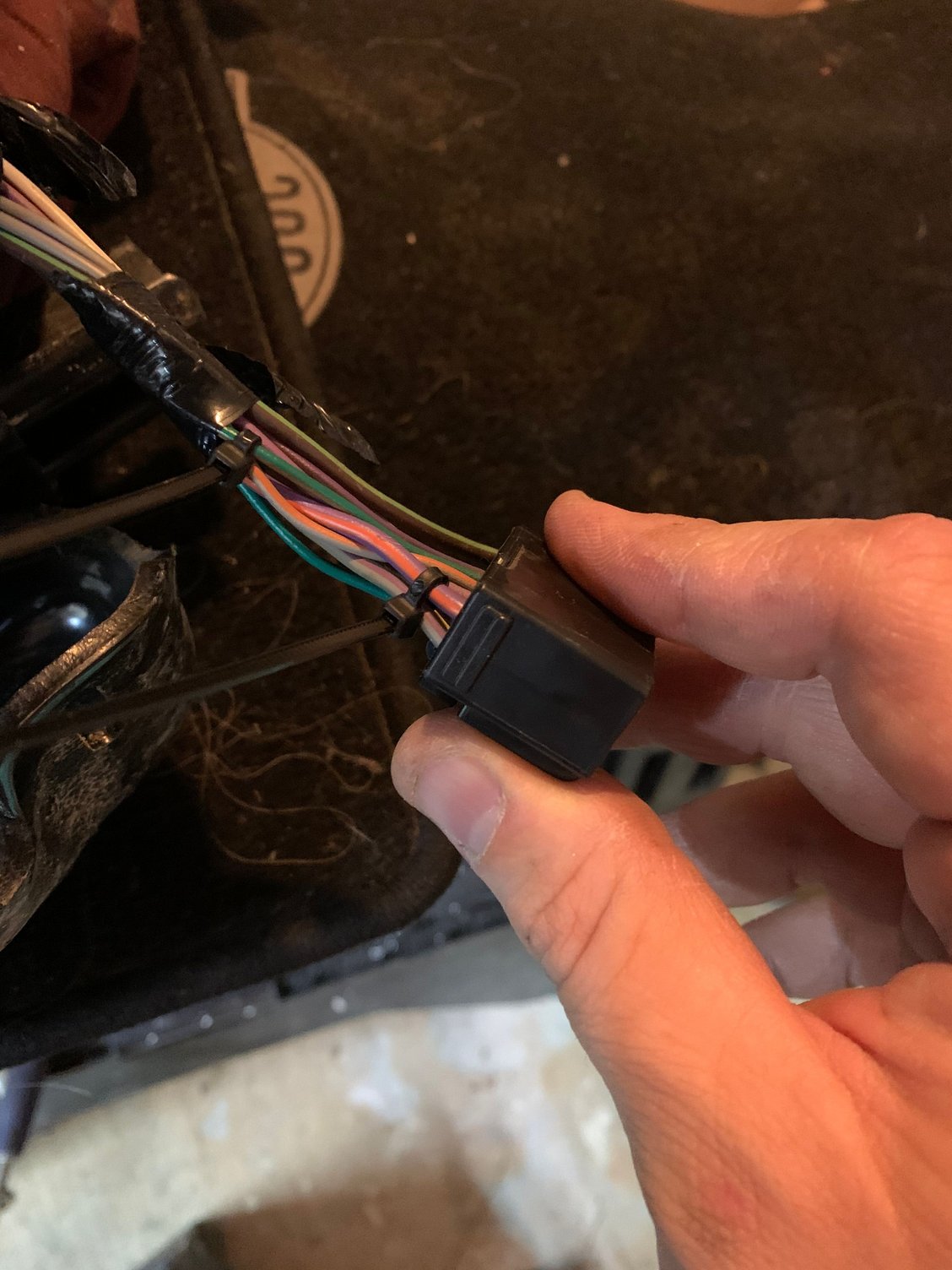

I have this in my build thread also. No body is commenting, so I’ll ask here.
my seat back recline/tilt motor has 4 wires going to it (they are zip tied) power, ground, and 2 trigger wires (I’m guessing) green/orange stripe and light gray/orange stripe. Does anyone know if there is a tilt switch that accommodates 4 wires?
I’m going to source a passenger harness to control the base movements (I’ve tested with my pass harness and it works).
I’m replacing this switch which has all the memory Stuffs.
Any help is appreciated!

Originally Posted by Edgethis
Why are you replacing the switch?
I couldn’t get it to work. Tried applying power to all the usual suspects... NOTHING!

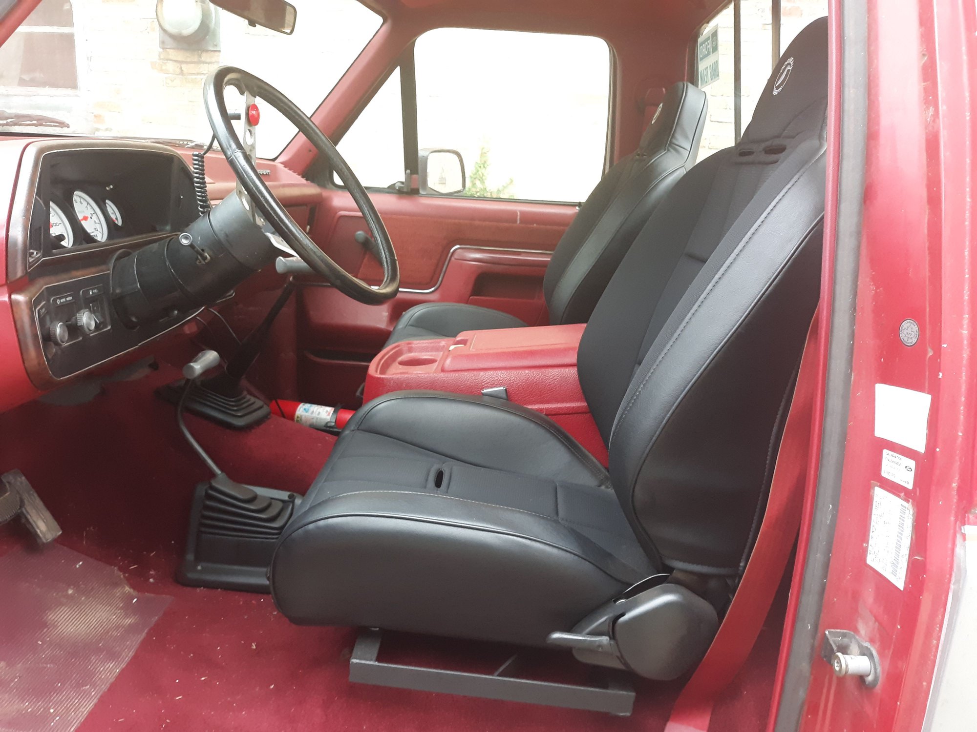

Since my thread is still alive more than a decade later, I guess it makes sense to post my own seats.
Corbeau suspension seats in my '94 F350. The Corbeau brackets bolted to the floor with no issue, lined up great. The space between the seats has exactly enough room for this console. I think it is out of a brick nose Bronco(?) but I honestly do not remember. If this were the truck I drove every day, I would have taken these out already. The side bolsters are a PITA to climb over to get out of the truck. Not a big deal for truck pulling, but would certainly suck if you got in and out of the thing every single day.
