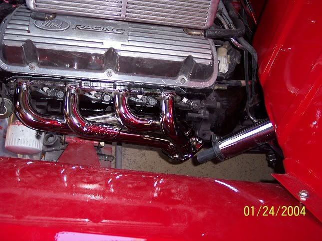

A 30" column wouldn't have cleared my headers. I have a 33" with a 4.5" drop(I wish I had used a 3.5" drop instead).
