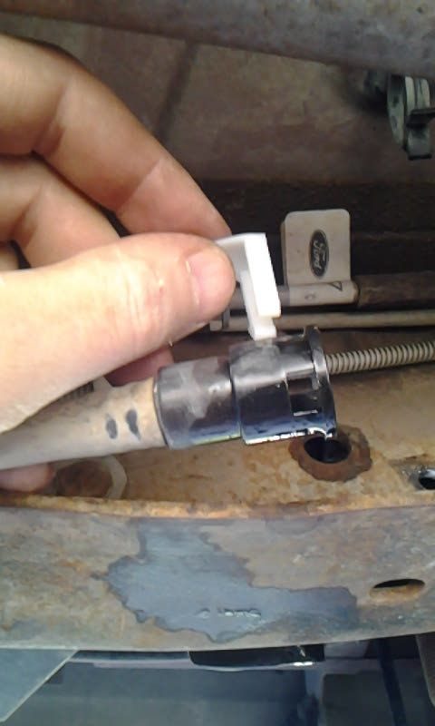

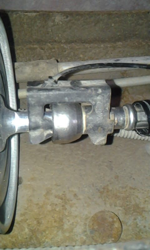

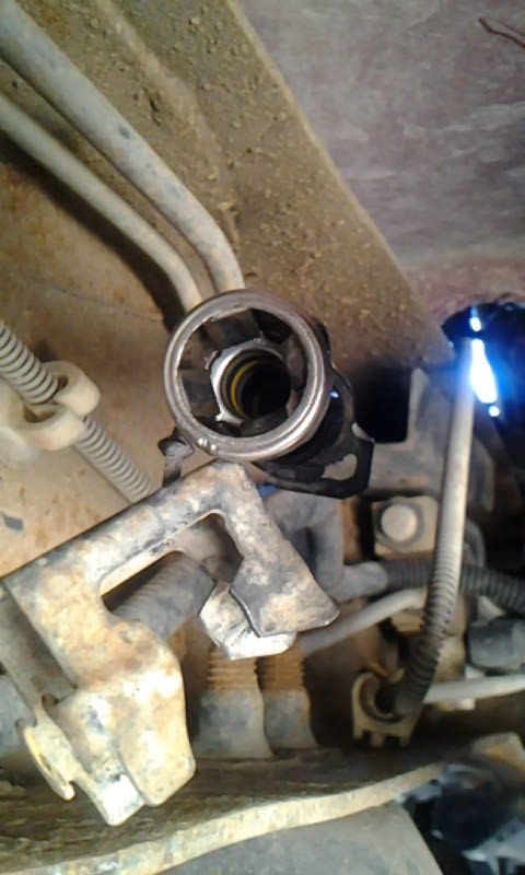

Here are a few pics to help the conversation.
'97 Ranger XLT 4x4
Inlet Side with "Horseshoe" Clip. Pop the clip out and slide the hose off the end of the fuel filter. After the clip is removed, it is just held in place by o-ring friction.
Outlet Side. Remove the metal retainer clip by sliding upward. Using the special tool or something similar, compress the 4 metal fingers inside of the connector mouth in order to get the outlet side hose off.
Outlet side with 4 metal fingers visible.
