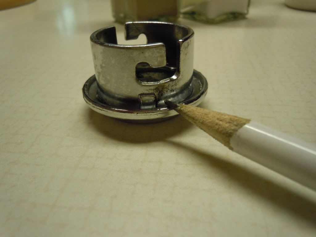

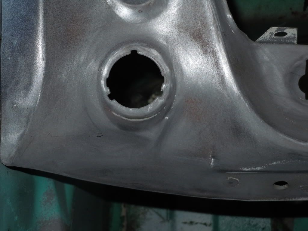

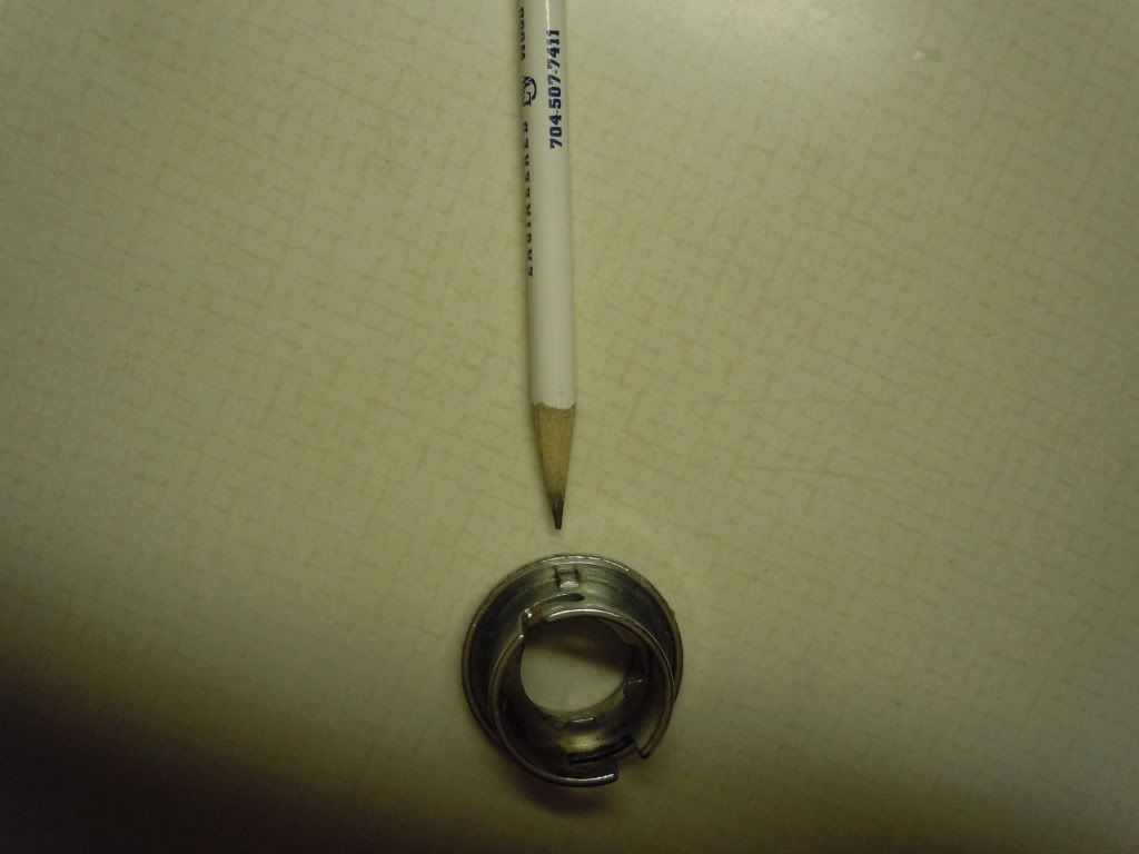

Here you go, pgr 380. Maybe this will help end the confusion the Self-proclaimed know-it-all started. The two horizontal notches are the locking notches to keep it from turning. The other three are to hold the cup behind the hole in place to keep the switch straight in the dash hole.Here are the tabs on the bezel I was talking about.

i dont think the bezel fits the notches in the dash! behind the bezel there is a bell shaped piece with the spring that stops it from turning... the bell shaped thingy has the tabs on it to fit the dash.
