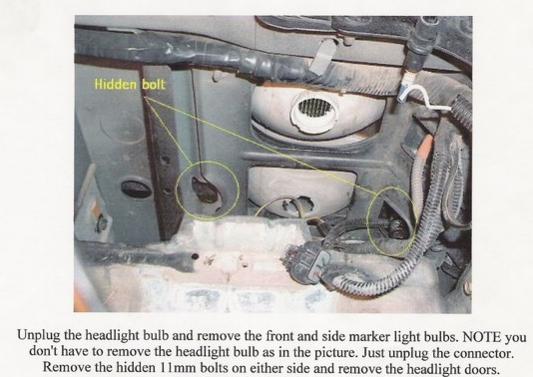

Can I easily take the trim off from around the headlight (key word being "easy")?

No you can't "easily" remove the trim, but I think I would. Open hood, remove all of the screws on the top of headlight doors (that's what the trim is called) and the grille. Remove grille NOT the headlight doors. There are two (2) nuts (11mm or 7/16") on the back of each of the turnsignal lenses (the long light under the headlight) which hold the bottom of the headlight door (along w/ the turn signal & side marker lenses) to the headlight mounting panel. You may need to remove the batteries & trays depending on how well you can manuver your hands around in a tight area. The studs may unthread from the lens instead of the nuts coming off that's OK just grab the stud w/ locking pliers after all else is removed and then remove the nuts. IF the nuts won't come off make sure they will tighten so when you reinstall the headlight doors it will tighten up.

Thanks for responding, Wow! There really is no easy way to remove the "doors"

Thanks for the lesson on the front end bueaty removal. I did not know it was going to be that "difficult".

For future reference Name:  HEADLIGHT HIDDEN NUTS.jpg
