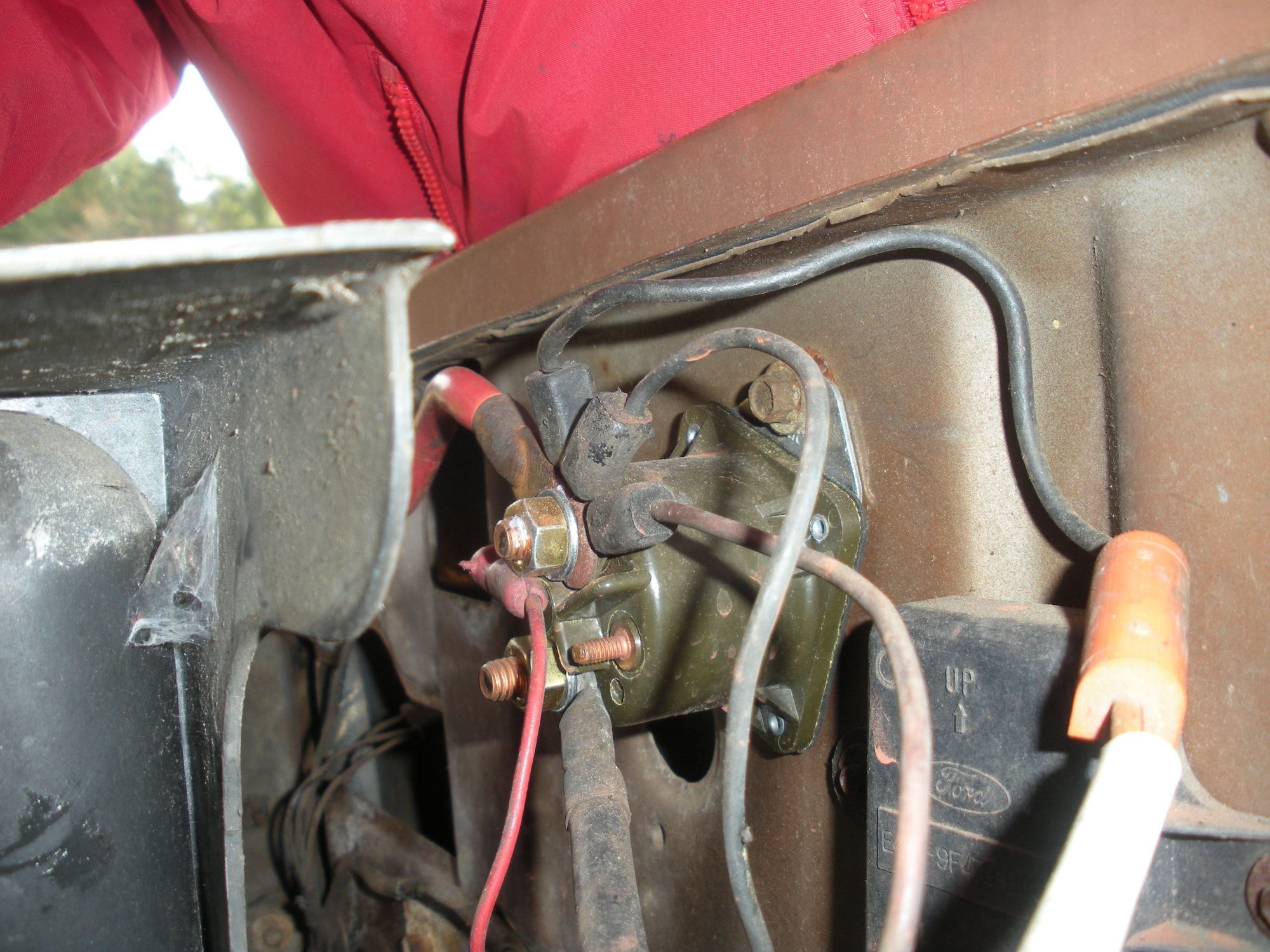

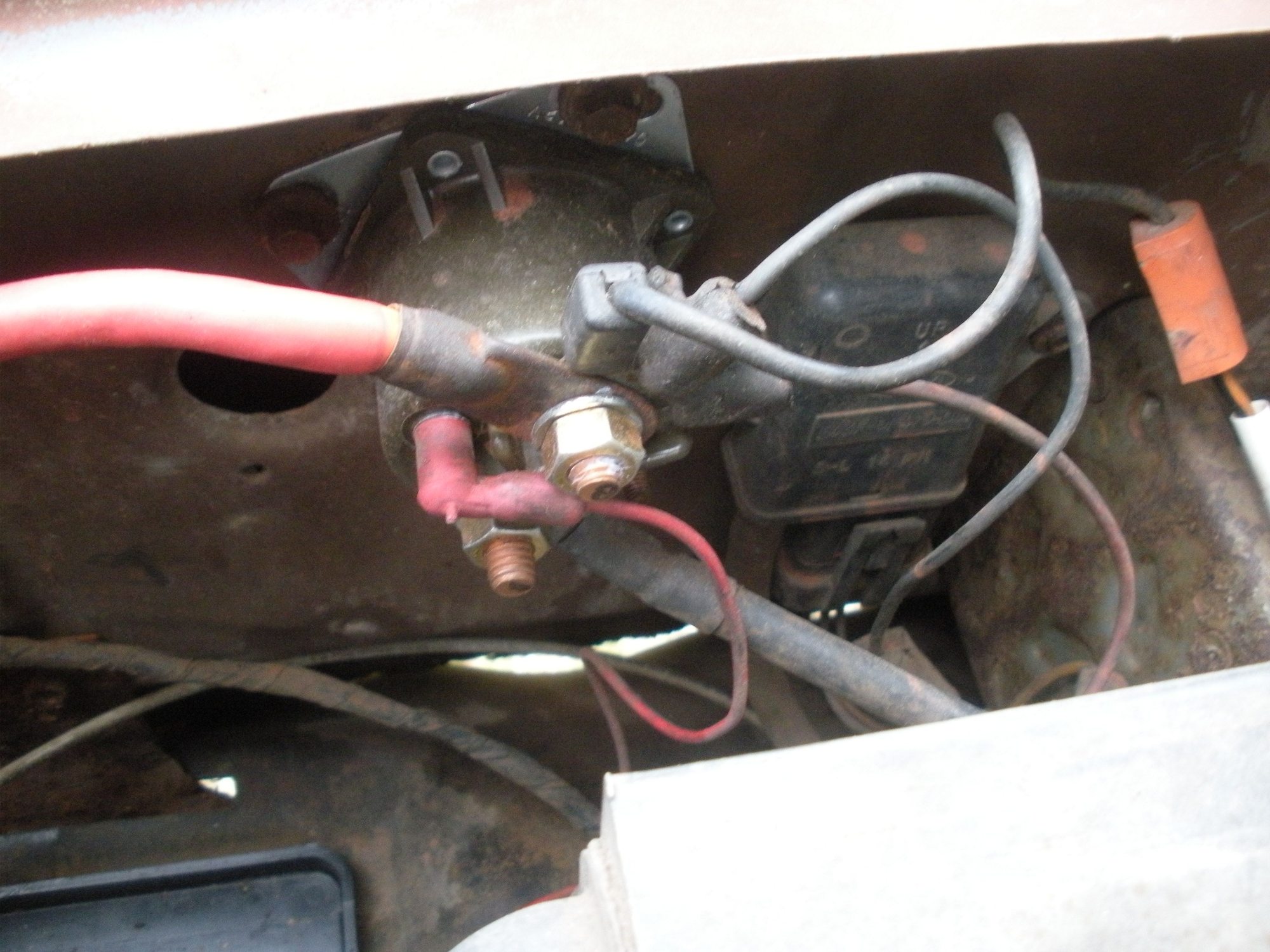

FWIW, here's a picture of how most are hooked up.
