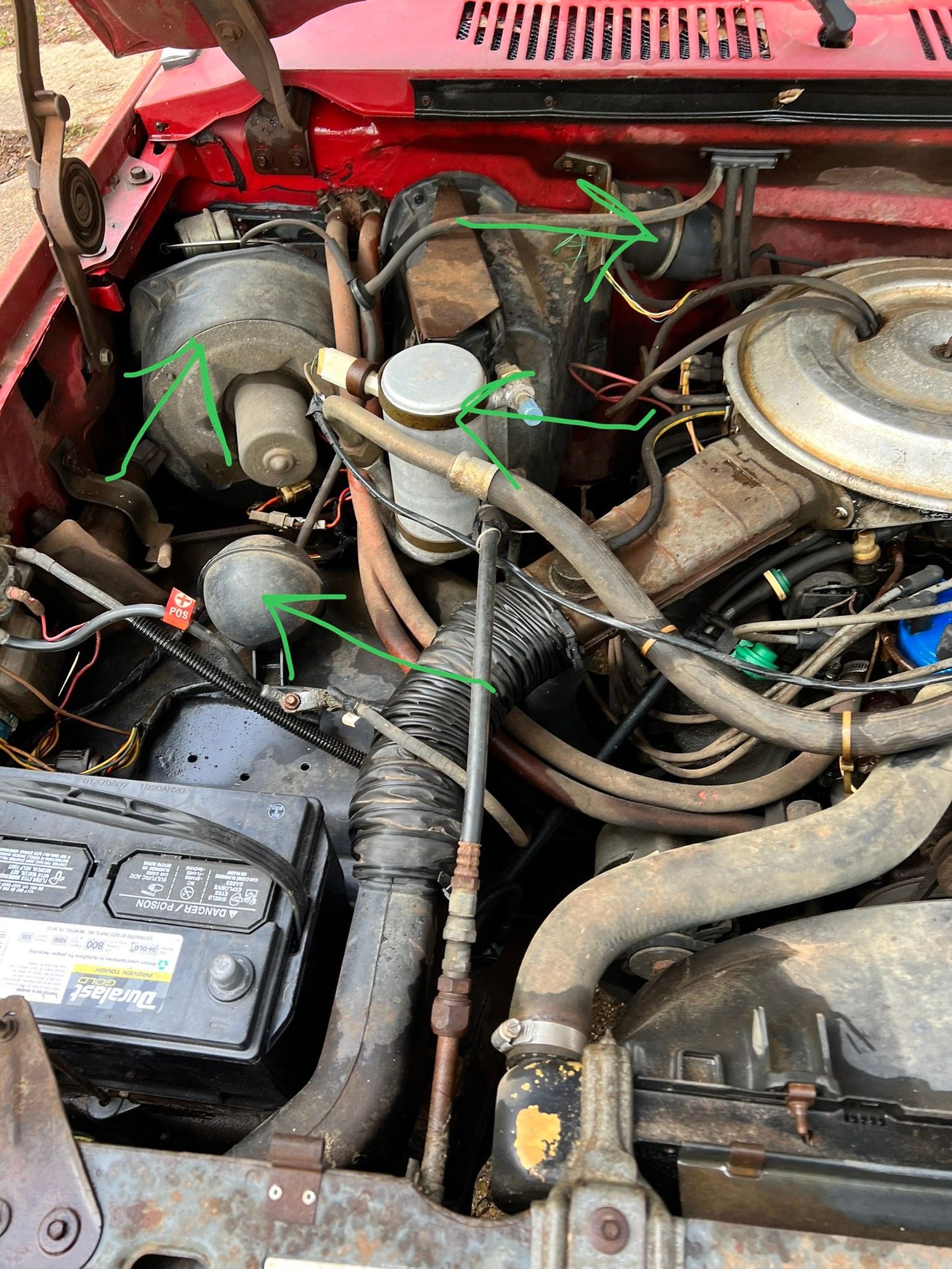

Could someone please tell me what these specific parts are in the pictures? They’re marked with arrows. I appreciate it!
I really appreciate it!

Blower motor, and two vacuum canisters in the first pic. Oh, that can looking thing is part of the AC system,
Wiper motor and I think ignition control module in the second pic.
Under "documentation" here you'll find lots of answers.

Oh, it looks like your brake booster has a leak too, you can see that where the master cylinder is bolted to it.

Put numbers on the arrows in the pictures so we can have a reference.
Accumulator/ receiver drier
Yes
https://www.garysgaragemahal.com/
I appreciate the help! I apologize for the brain fart and not numbering the arrows to make it easier! That was dumb of me! I have enough to go off of with what you said! And the truck doesn’t really have front brakes Anyways, so I’ll be replacing pretty much everything in that system! I appreciate it!!

What is the one I have circled in red below? Is that a vacuum motor for a dealer or aftermarket cruise control? That's what it looks like, but they're not usually in that location, at least not that I have seen. Then again, none of my Bullnoses had cruise, factory or aftermarket...
I think you are right. That mounting bracket does not look stock. He could check and see if that black thing has a cable going to the throttle arm.
I’ll take a look and see what it’s going to. I’m pretty sure it doesn’t touch the throttle, from my recollection, it just has a few tubes or hoses connected to it. I’ll try to see from where and let you know
if somehow this truck has cruise control, I’ll be more than impressed!
Well, as ya’ll thought, it’s connected to the throttle sure enough. Honestly have no idea what it’s going to, I have nothing on the dash or any controls that would indicate cruise control. You have any idea I pursue to figure it out?
