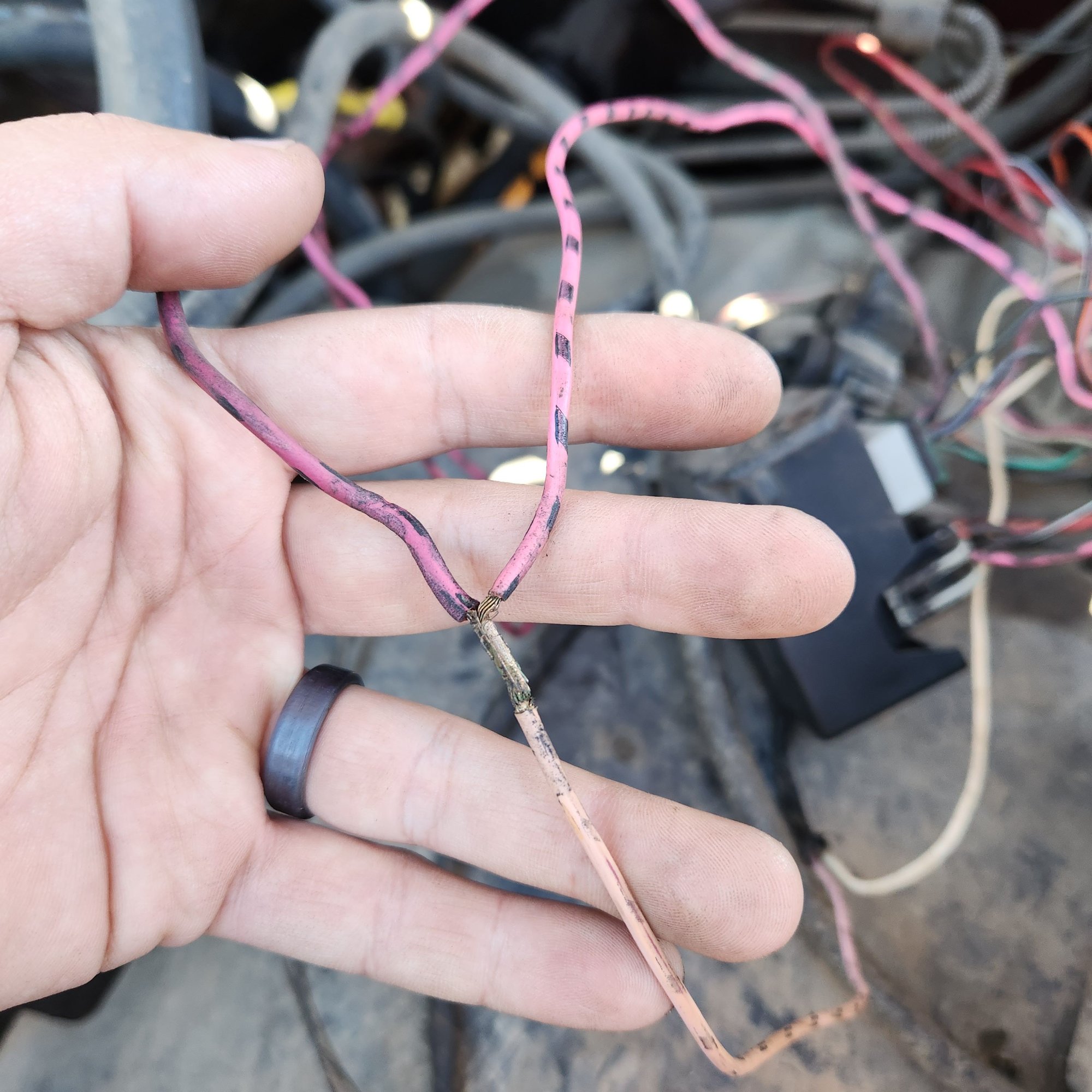

There is about .6V on the I wire on run. Switching the two wires results in no crank. Can you verify that the S wire should be getting it's power from those relays (fuel pump relay and a second relay right next to it, I don't know what it goes to)?
Each relay has a pink/black dashed wire that splice into what becomes the S wire at the solenoid
Looks like a factory splice...
S wire terminal

So my S and I wires were, indeed, switched; the S wire (red and blue) did, however have a break in it somewhere and it wasn't tripping the solenoid. I ran a new line from the ignition switch to the S post and bingo, bango.
The truck fires up with the key (my original intent) but now I wonder what that I post is supposed to feed and if I need to reconnect it to it's proper destination.
