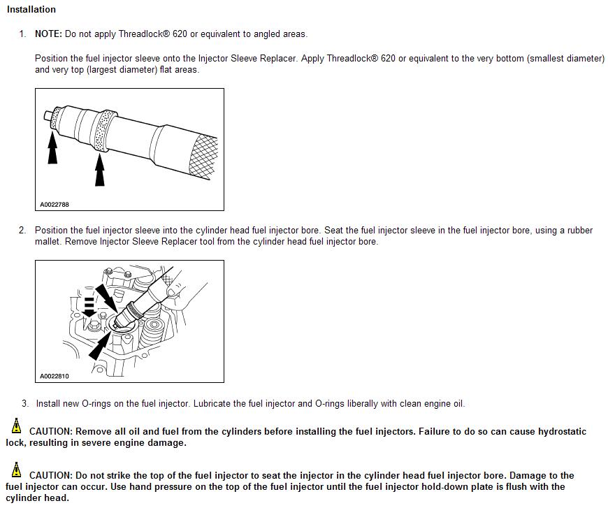

Drain the block as well of coolant. Remove the oil deflectors and then the injectors. Remove the hold down bolt pictured below and slide the collar up and remove the injector. Remove the rear most injectors, #8 and #7 first to allow the oil and fuel rails to drain into the cylinder. Remove it with a mighty vac or such. Then remove all the glow plugs as well.

Here are some pictures of reinstalling the new cups.
Here are the torque specs for everything else.

I can't take credit those are just screen shots from the Ford Manual.
We do have the tool available for rent with cup purchase, and will be selling the tools as soon as we finish a few last changes.
