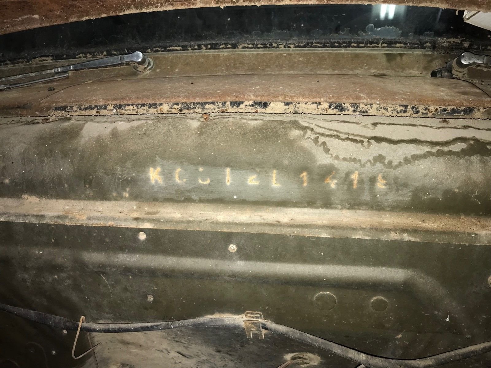

Here it is. Thanks for the assist.

Kansas City assembly plant
3 is code for Black
12L is Nov 12, '51
1419 is assembly line code for vehicle
I haven't been able to come up with anything on your model designation WBC

So, Tim, ponder this with me for a minute, please. I know it's been conventional wisdom that model year follows calendar year for our trucks, but I see an anomaly here I'd like you to consider and give your opinion on.
88chicken's truck has the early glovebox plate that, according to the catalog, was superceded by the new style in September, '51. Going back through the list we have and looking at KC trucks, it appears they built about 18-20,000 a month, give or take a few, throughout 1950, and for the sake of argument, lets assume that continues forward. According to the catalog on the 1951/2 data plate decoder, the consecutive unit numbers started at 10,001. The tag in question here shows a unit number of 18149, which would mean the 8149th truck built at KC, and a date code of 12L (November). The latest date code we have listed for 1950 at KC is 12K (October). All of this leads me to believe that 1951 model year production may have started somewhere near November 1, 1950, at KC, and this truck may one of the earliest '51's built, November 12, 1950? Thoughts? For the newly facelifted trucks for '51 to be in showrooms by the first of the year, it stands to reason they'd get a head start on production.
