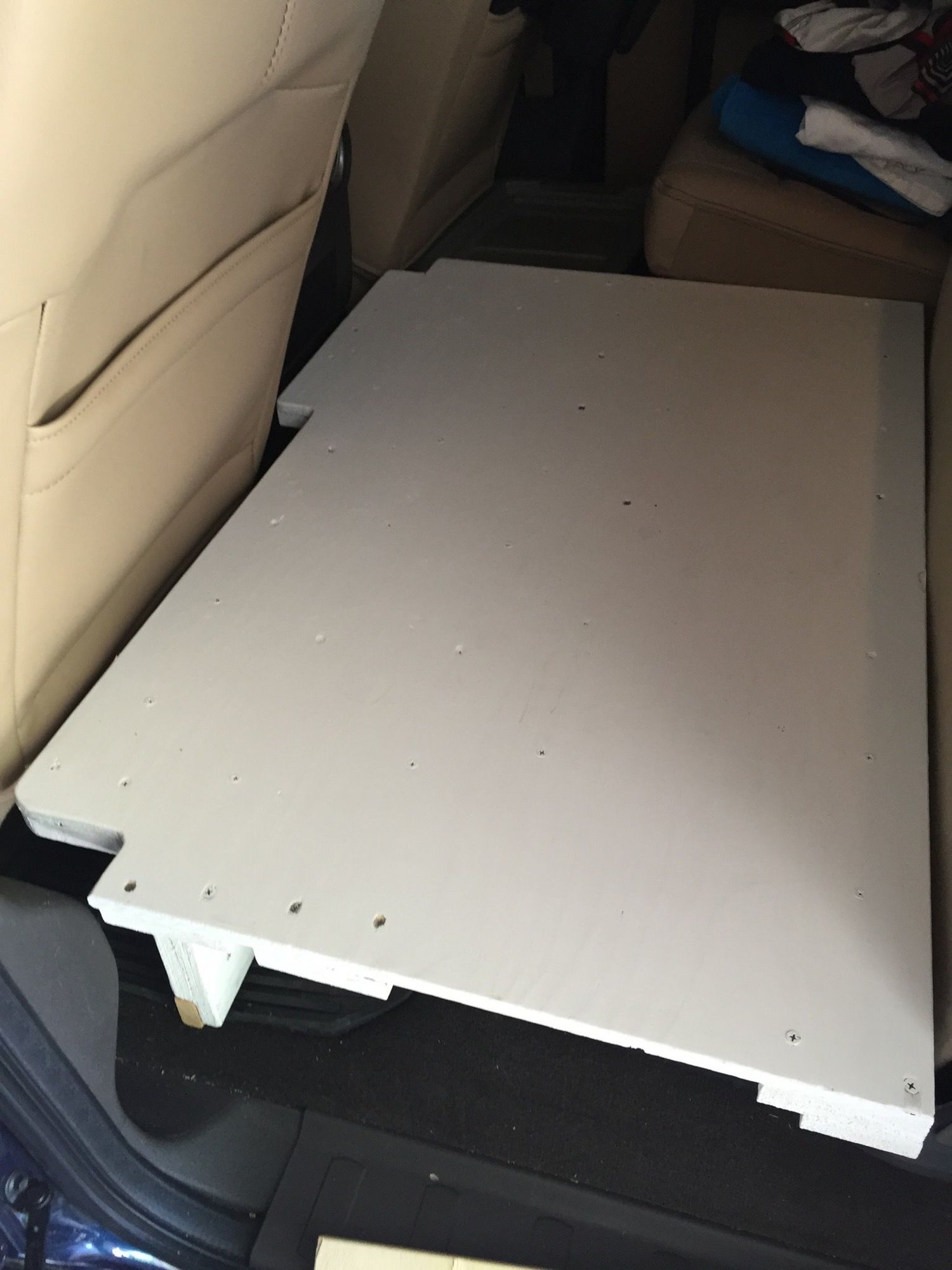

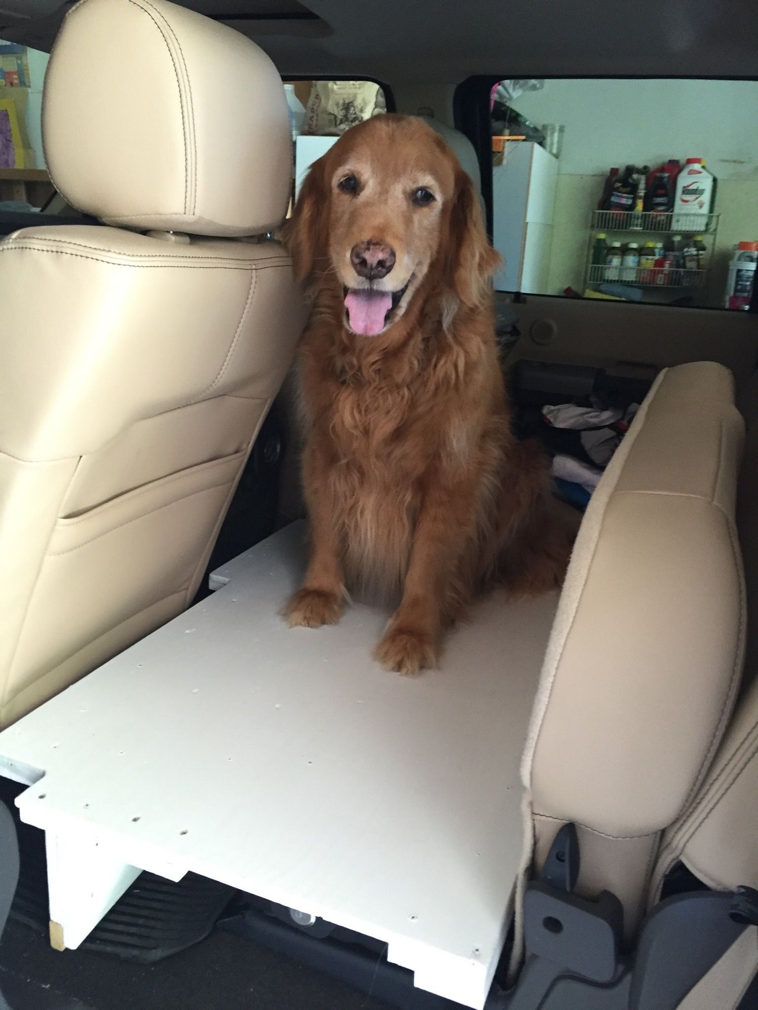

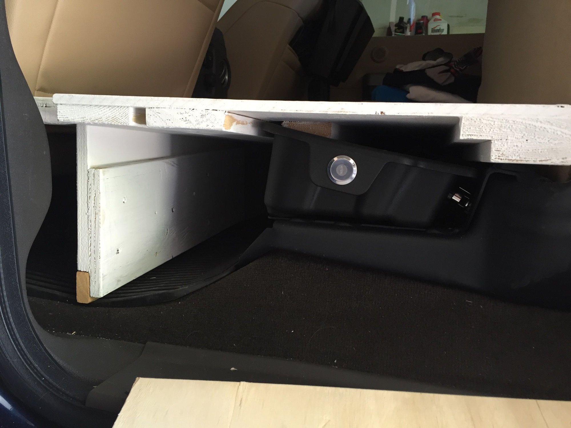

Without the fold flat floor of the 2017, wanting to keep the storage bins, and not wanting the dog to be on the seats, I decided to build a flat floor for the dog.
Here are some pics from this weekends work. Pics were before 2nd coat of paint. Final step is to glue some marine grade carpet that I have onto top and edges. I used 1/2" plywood and 1x4 pine to stiffen, and to add support. I used 3/4" plywood for the front support leg. The leg is held in position with a friction fit between 1x4 pine cleats. It was a little tricky getting the front leg curved correctly for slight crest in floor. A cleat inside and outside of the storage bin keep it from moving forward and backwards. The front leg keeps it from sliding from side to side.
It is light weight and the front leg support comes off for flat storage

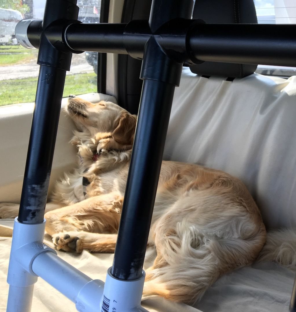

OK, here ya go, nothing special. Just 3/4" PVC and Krylon black satin rattle can paint (the stuff good for plastics).
It is just a bit narrower then the seats and is an interference fit between the floor and roof.
I have tried this several different builds including the wings out to the opposite ends of the head rest. Since this version fits regardless of seat position (bottom or back) it has worked the best. I also tried commercially available dog dividers. That was a pain to take in and out.
Now this will not keep an agressive, strong dog in the back, but you can't bring those dogs to campgrounds anyway, and camping is what we do because of our dogs.

Old Jun 7, 2016 | 04:25 PM
  #90
David_ski's Avatar
David_ski
Joined: Apr 2016
Posts: 193
Thanks for the ideas and pictures of your implementation.
I too have given up on the commercially available dog dividers for that same reason.
I have a couple of ideas for a backseat to front seat console divider. I could drill a couple of holes in my platform as bottom anchor points for the PVC. I can then take it to the ceiling like yours, or I can use a the headrests as a upper stop. My first test will probably be a headrest attach.
