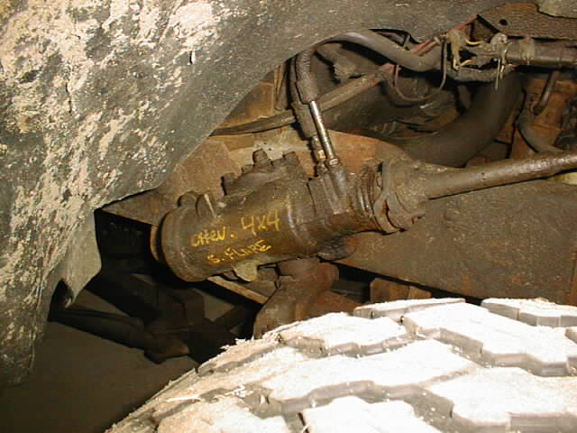

I used a 70's vintage chevy box , an olds rag joint & intermediate shaft . The tie rod from the chevy box on one end & a ford tie rod on the other . Shimmed the angle of the box with a bracket welded to the frame to provide the correct angle .
The lines from the pump were the same
Later on I shortened the arm on the axle to tighten the turning radius .(removed an inch and a half)
Name:  76 Steering good pic.jpg

With that box being outside of the frame, could there be a problem with big tires hitting it ?
Old Dec 30, 2010 | 05:10 PM
Action4478's Avatar
Action4478
Joined: Aug 2006
Posts: 10,764
Likes: 39
Mine are 31x 10.5 & a fairly standard height Truck . A little added re curve to the front springs to level the truck ..
No rubbing ...Even with the fairly tight turning radius it now has . Steers like a car too. One finger while sitting still with the plow on it ...I also have a 79 steering column that has a little smaller wheel ..No effort steering .

My truck is stock height, but it has 33x11.50x 16.5 all round. I think the two drive chevy box is going to be my route since I already have the box, I can drill and weld.
Can you guys post up a picture of the linkage going from box to the axle. I'm the type that can read on something all day, but once I see a pic, I can go do it.
