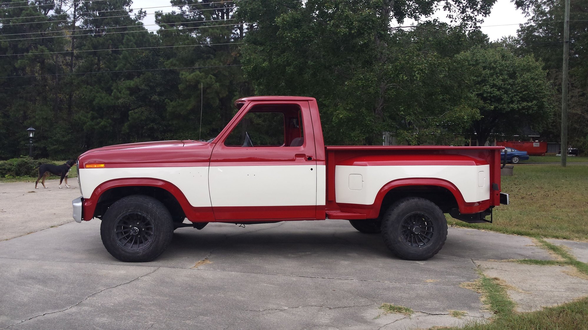

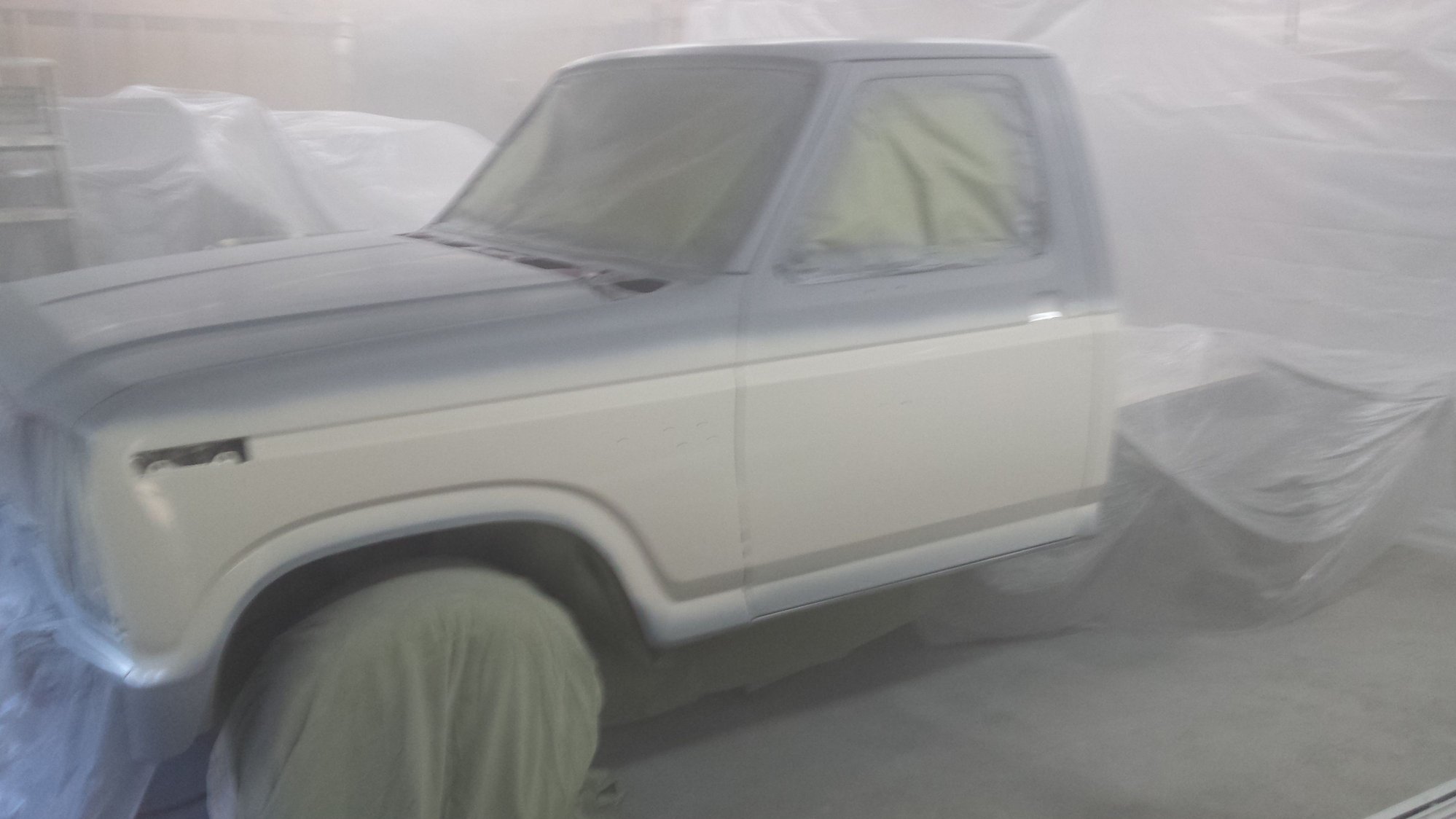

So you know what I am saying on how to paint it here I did the light color (white)
Then I used fine line tape to make where the 2 colors meet and taped off before the red went on.

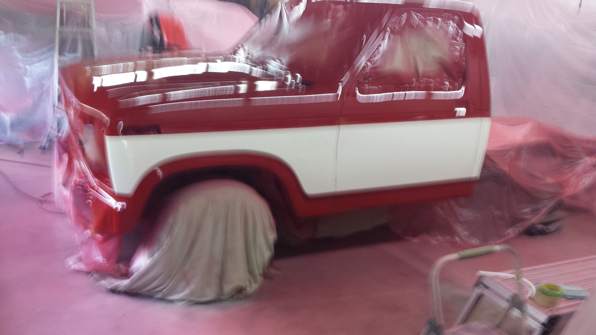

Here is after I let the red set up some and pulled the tape & paper off.
Here you can see the white is taped off and the red just put on the rear fenders
All painted but still needs to be put together and cleaning up.
Dave ----
78 Ford F150 460
