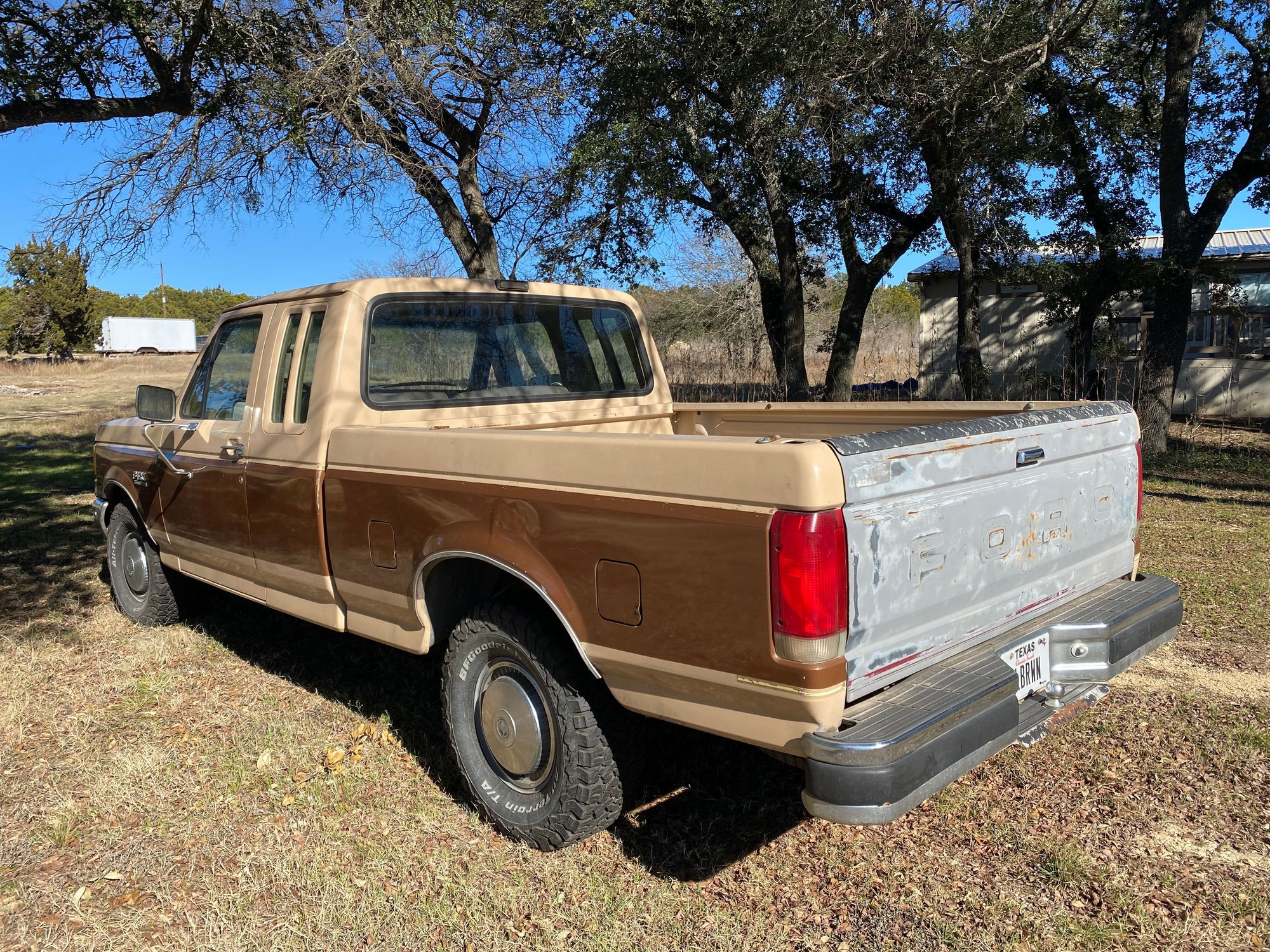

is this a dark brown or black paint? Can’t seem to find the original tailgate to my tan/brown/tan 1990 anywhere

What picture you talking about?
If your truck is the top 2 then just look at the color codes on the sticker in the door jamb.
If the bottom picture the gate looks like black & tan to me and again you can look at the sticker to see what the truck left the factory with.

mine is the top 3, color codes Pawnee tan and desert tan metallic as the darker brown. I have been trying to find an original but the darker brown one seen is the closest one I’ve seen. I had hoped it was for sale if the owner found one that matches his bullnose era one

I think finding a used gate is good shape would be 1000:1 and then find one in your color combo would be 10000000000000:1
If you have a good gate now or can get one no mater the color just repaint it.
You can get the right colors mixed and put in spray cans. using the color code off the door jamb sticker.
Not knowing the shape in person, nicks / rust / etc. I cant say what prep would be needed but from what I see that flaking primer / paint needs to taken down to a base that is solid. That pin stripe will also need to come off and any nicks etc. need to be feathered edge out, bare metal primed and the whole gate sanded with 400 grit sand paper or even 600 grit before being painted.
You dont need to tape off the line between the 2 colors for the first color going on.
I would do the light color first, top edge & bottom edge. Wiping any dirt off before spraying.
When that color sets up, a day should be good depending on the type paint, use fine line tape in 1/4" wide to make the line between the 2 colors. (I have used 3/4" making tape in the past)
Then use wider tape (3/4" making tape) on paper (I had used black & white news paper), folded over about 4" before the tape is put on the paper fold edge half on paper & half off. This half off part of the tape put on the 1/4" fine line tape amd use other tape to hold the paper from blowing onto the painted part.
1 last dusting to get any dirt off the gate and spray the dark color.
Let the paint dry an hour or 2 and remove the tape but dont touch or move the gate for a day as you can put finger prints in the soft paint but the tape has to be removed before the paint gets to dry / hard.
Its not all that hard to do just takes time and why body work / paint is so much dollars it time!
Dave ----
