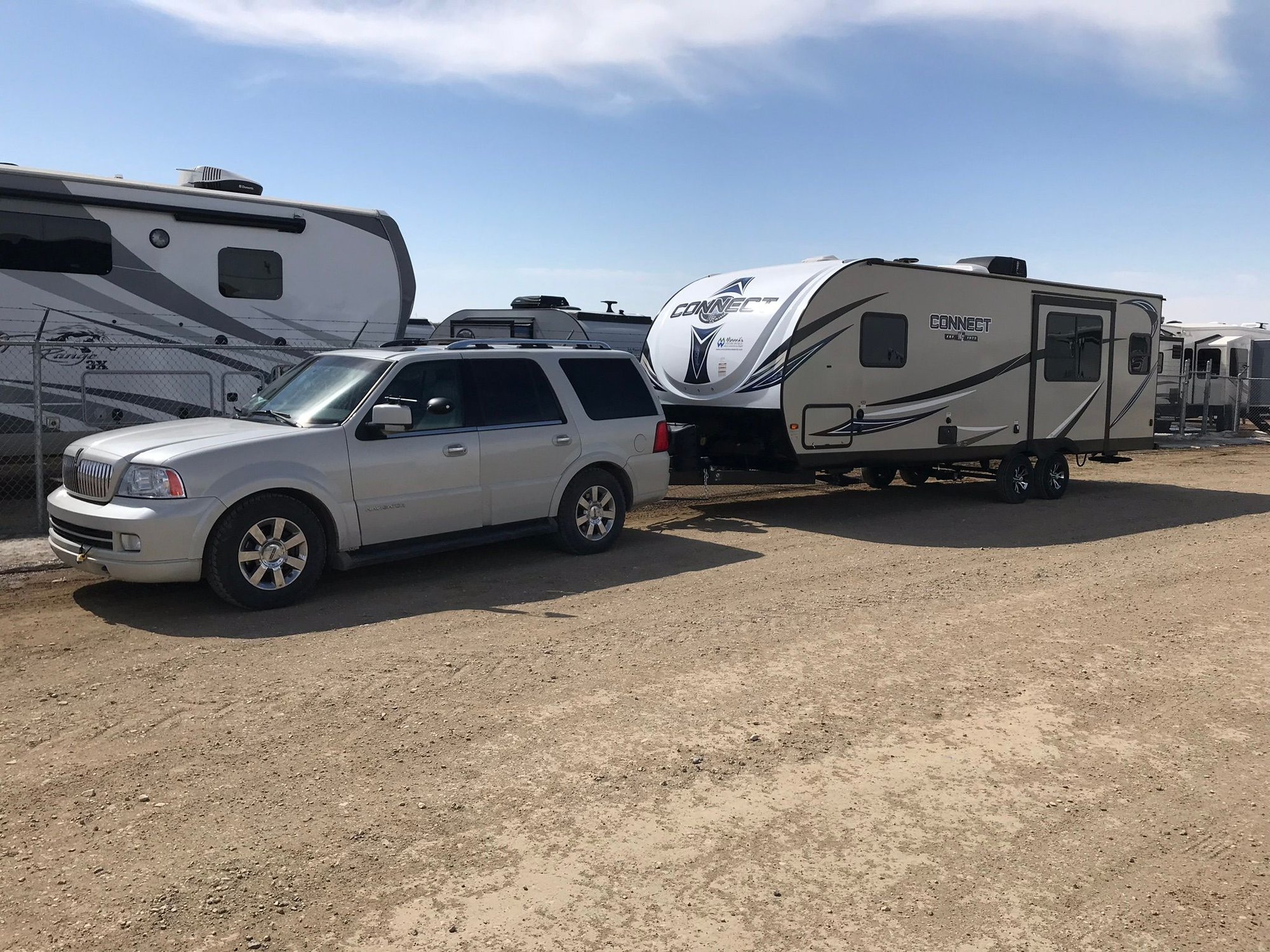

My Navigator has the tow package, and the 16 diffs, open, 3.73 ratio, and i tow a 6800lb trailer with it, struggles on the steep hills, but overall tows the trailer quite well for the power output and size of vehicle! I would really like to find a limited slip 3.73 rear housing to swap in, would make winter driving better I’m sure!
