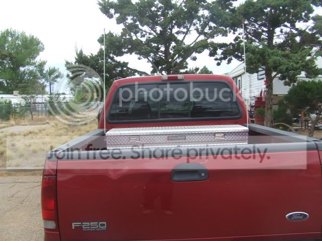

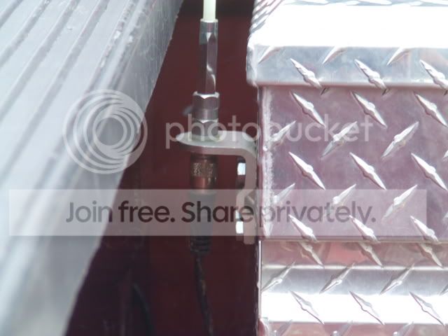

Here's my setup?????
What you can't see is on the bolts that hold my tool box down....I ran Ground Straps to the Frame.......Made a big Difference!
You got quite the setup in the cab!!! could you get a front view of your truck? Thanks Kyle.

If I don't get home to late tomarrow.....I'll post a pic from the Front .
