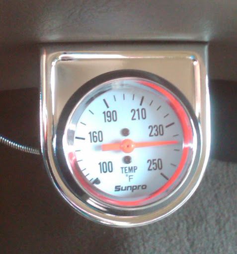

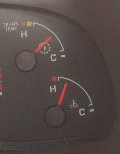

So I installed a mechanical gauge from Autozone for $17 in the extra port on the water pump.
Generally driving around town the temp is anywhere from 195 -210.
Today it is blazes hot here in Richmond, VA and I had the AC cranked and drove somewhat aggressively around town and got the truck to get hot.
Here is a pic of the factory gauge and the corresponding mechanical:
After this temp, I quickly cranked the heat and let it idle for about 10 minutes - got it down to 220 before I had to shut it off and go into work for a meeting. So it looks like the gauge is doing its thing - everyone betting it is the water pump at this point?
Thanks
Joe

I have a Scan Gauge, and I intended on putting a coolant temp sensor on, but after monitoring oil temps, adding coolant temp would be a waste. If one goes up, so does the other.
You have a failing water pump or a blocked/clogged rad. Could be plugged outside with crud, or inside. Look at it by lifting the soft flap near where the tire tools are mounted and see if there's junk in there. You could also check the hoses for flow and/or temps to see if the radiator is cooling or flowing enough. Lots of things to check out here....
Could be fan clutch too, I suppose. The fan is VERY loud -- loud truck on not, you'll know it when it locks up & starts spinning the fan full-speed...

hey there i see a trans gauge by your water gauge did 02's come with it
Old Jul 7, 2010 | 06:17 AM
jpcjguy's Avatar
jpcjguy
Joined: Oct 2009
Posts: 270
That is the factory cluster.....
