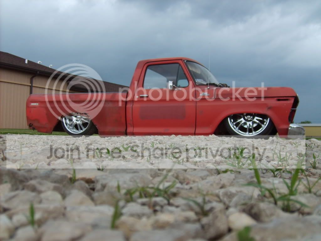

a friend here in Des Moines is building a 78 f100 and its got a 98 crown vic sub frame he grafted on. Not sure of the measurements on the stub but should get the measurements. If any of you want to follow his build its over here on our Iowa forum: Iowa Minitruck Association - project f-100
Really good pics and VERY in depth step by step. Good readin!!!
heres a tempting pic!!!

Anyone who is considering this IFS needs to pay close attention to the photo above...this truck has a wider track than an F1 or an early F100 and still the wheels are right at the edge of the fenders. Take a look at the wheels...remember what I said about the offset, you can push the rims in much farther than these.
