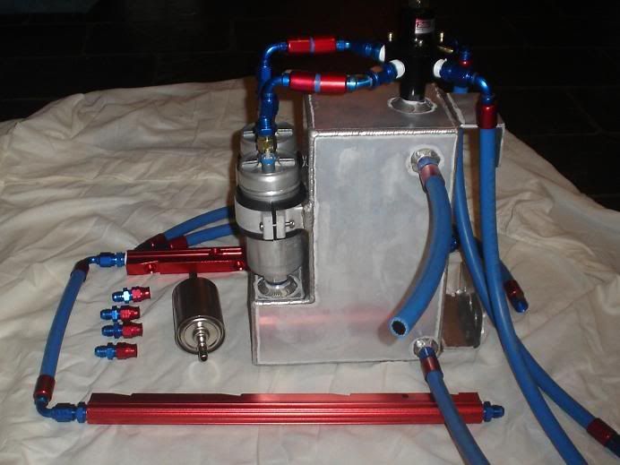

Twin 044's anyone?

Originally Posted by Kwikkordead
Twin 044's anyone?
That's sharp looking, but given the tank size, you'd NEVER pass a fuel stop!!
